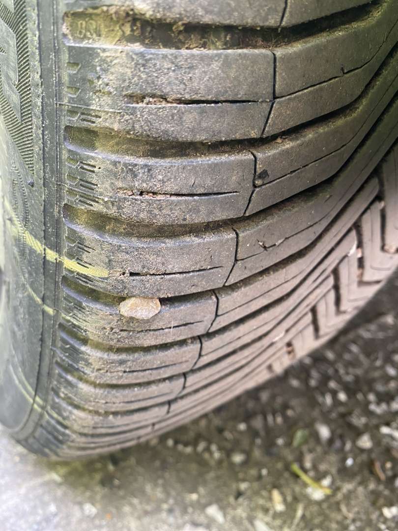

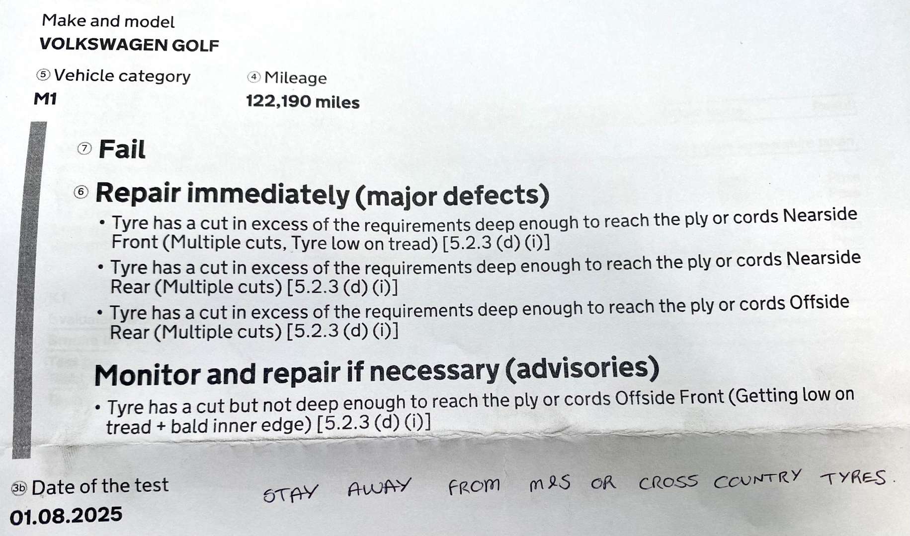

 IMG_4328.jpeg Just failed MOT for tyre damage. Fair, they have numerous cuts from stones.
but the handwritten note! Second time a mechanic has commented on my Michelin cross climates being unsuitable.
but after 4 years and 20,000 miles I think I’ll be ignoring the advice and ordering 4 new ones. They’re brilliant and I don’t understand why the motor industry insists on putting english drivers on summer tyres year round.

You know what, as I’ve digested this and done some googling, I think I’m being taken for a ride.
Aside from the cuts, the front tyres are noted as “low on tread”. I’ve just measured them with callipers at 4 mm, MOT minimum is 1.6. I like to keep on top of these things
ive just looked at my 2nd car which recently passed an MOT and the tyres are covered in similar small stone cuts.
inspecting my car after the MOT, yes, the tyres have picked up a lot of gravel, but that’s because (ah the irony) I drive home last night through heavy surface flooding and mud.
Does anyone else think that he just failed my MOT for the hand written reason “avoid M&S (mud and snow) tyres”?

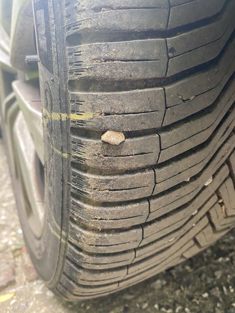

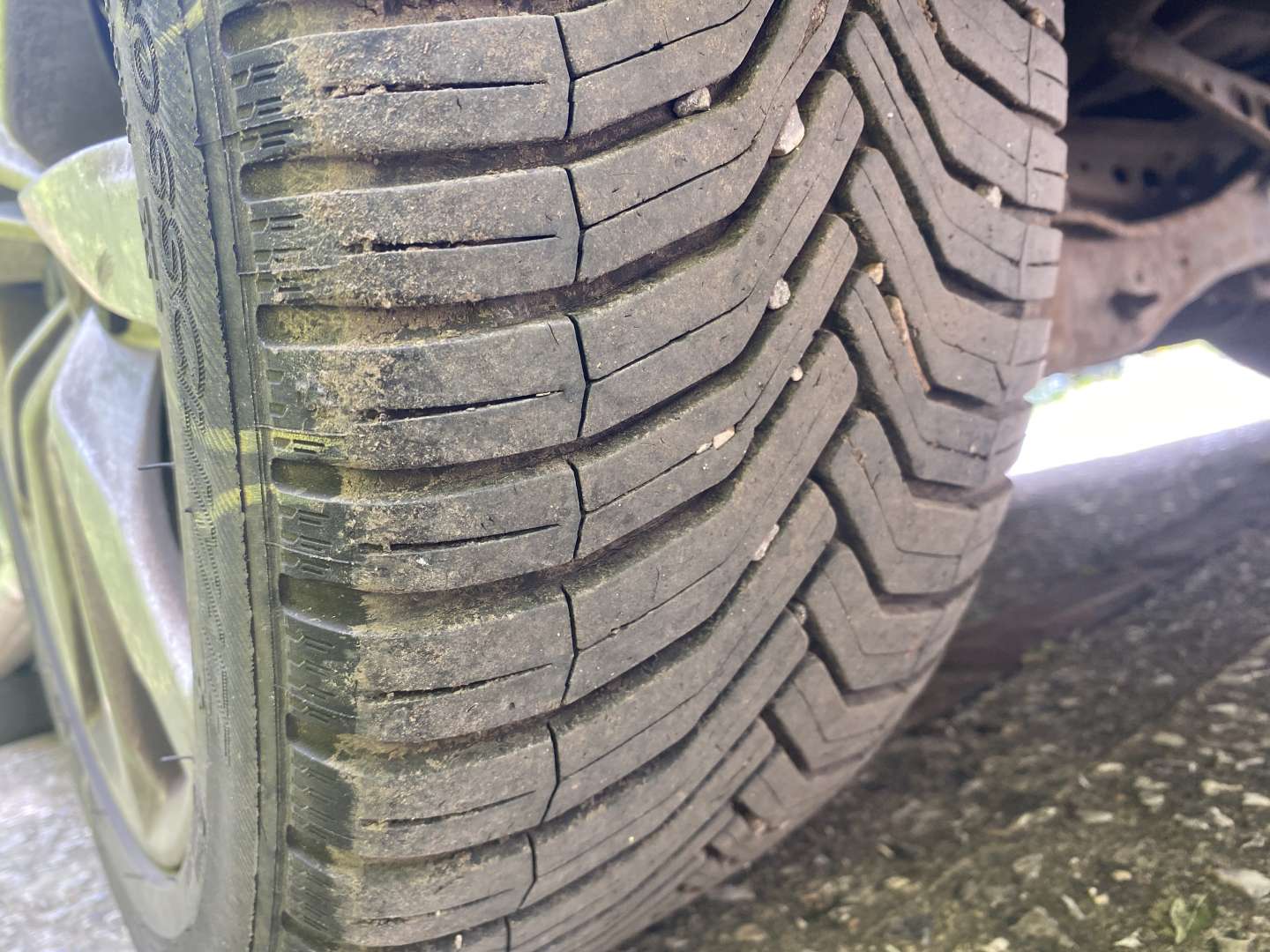

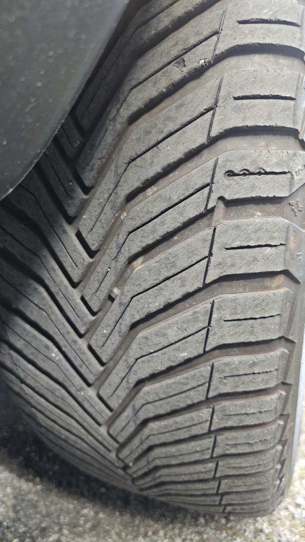

 IMG_4329.jpegIMG_4330.jpegIMG_4331.jpeg Can anyone spot any concerns here? Chalk marks from the MOT technician.  This tyre looks fine to me, plenty of measured tread depth, plenty of stones for sure and a few cuts that absolutely do not go anywhere near the cords. I’ll be visualising a two finger salute as I take my wife and family camping next week without an MOT. I would never do anything to endanger them or other road users.
source: arrogant PhD educated engineer. 👷‍♂️
disclaimer: please correct me if you think I’m an idiot. I’ve inspected the tyres carefully and I’m happy.

Does the tech mean those tiny little cuts across the sipes?
I would def keep driving those

Tyres look fine to me (what do I know though).
However - no MOT = don't drive the car anywhere unless it's to a booked appoointment for an MOT (or tyre replacement!).

TBF No serious damage is obviously visible in the pics, take it back down there and ask them to show you?
edit- that possibly would line up with the chalk, see if you can open it up, also look in the grooves where they are obscured in the photo

They look worn but fine to drive to me (IANAMOTtester) - not sure your tester knows what they should be measuring, frankly.
I've been driving CCs for 3 years now, and found them really good, especially in the dry, snow, slush and heavy rain. The only thing I dislike about them, and the reason I may look elsewhere when they need replacing, is their performance on slick - but not streaming - tarmac. When it's rained just enough to wet the surface and make it a bit slippery, they do slip, pulling away from a junction, going round a roundabout etc. Otherwise, great tyres.
Posted : 01/08/2025 2:56 pm

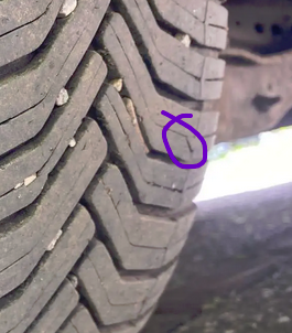

Mult21 has correctly circled in purple one of the stone cuts. I’ve been digging my fingers into all of these and they go nowhere. The tyre Carcass is fine.

You can appeal an MOT with the DVSA within 14 working days, form is on the .gov site.

Not sure about the anti ‘cross country’ tyre advice. Seems a bit rash if you’re regularly in conditions that need that kind of tread.
the cut shown does look deep and like you’re about to tear off a chunk of the tread with some rough acceleration.

We can all see the photo but have you tried MOT tester protocol and seeing if the sipe have indeed torn open to the cord. A good hard look and a photo will not show that.
When assessing cuts in a tyre, it is permissible to check whether a cut is deep enough to reach the ply or cord by using a blunt instrument to open the cut taking care not to cause further damage.
The following criteria should be used when assessing a cut in a tyre:
  • any ply or cord that can be seen without touching the tyre - fail
  • if by folding back rubber or opening a cut with a blunt instrument, so as not to cause further damage, exposed ply or cord can be seen irrespective of the size of the cut - fail

Just seen the hand written note - never noticed it on the bottom of the test cert.
Halfords you say.
Might want to let head office know about their testers giving out hazardous advice.

I've never checked the tread for cuts inside the sipes (sidewall cuts are the usual culprits)  but that is what you need to do. Get a flat screwdriver and a torch and gently pry open the sipes, it may be that the stones stuck in the sipes are cutting to the cords.  You will either see the cords, or if they are cut you will see them as dots in the rubber.
It's 3 points per illegal tyre if caught so seeing as you've been notified by a tester, it would be best to check yourself when if the tester has been a bit over zealous in searching, he might have just realised there is a trend with stones cutting into siped tyres!

As others have suggested pry the sipes open and have a good sqy inside.  Sharp end of a bike tyre lever  will probably get them open.

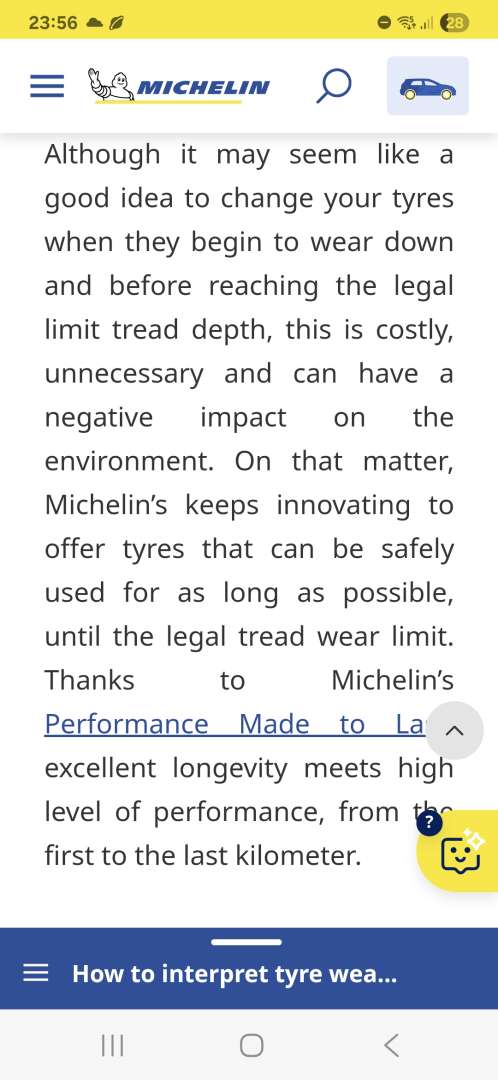

From Michellin's own website site...
The minimum tread depth is 1.6 mm. This means that it is imperative to change your tyres once this limit has been reached to avoid compromising your safety and breaking the law.
But it also means that it is premature to change your tyres before this threshold. This paragraph below how to check if the wear level is reached.
At MICHELIN, we design tyres with performances made to last. That is, they are able to provide an excellent performance right up to the last kilometre, when the wear threshold is reached. There are two main reasons why MICHELIN optimizes the longevity of its tyres : less frequent tyre changes save you money and are more environmentally friendly. This is why MICHELIN designs tyres that perform well until the minimum tread depth is reached.
https://www.michelin.co.uk/auto/advice/tyre-basics/tyre-tread-depth
A garage telling you to change them at 3 or 4mm wear is trying to fleece you.

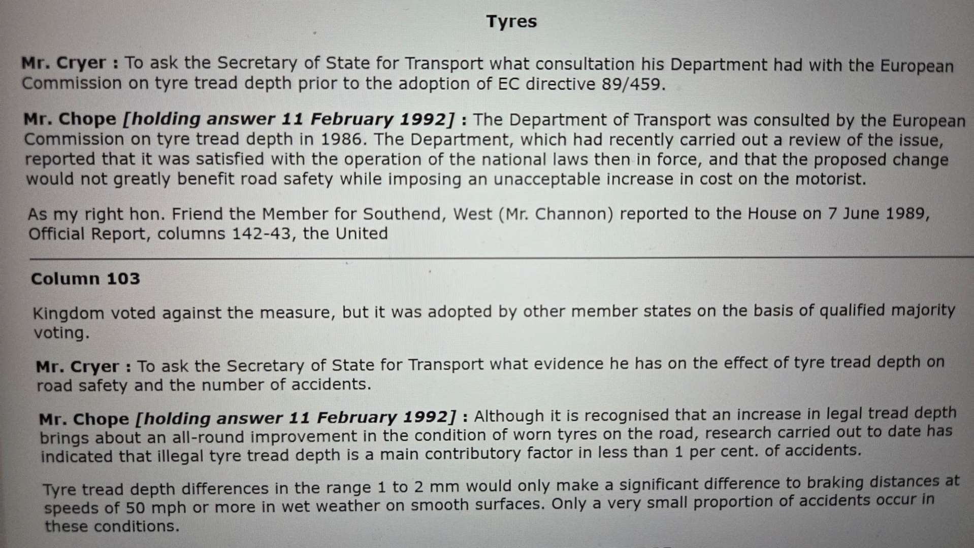

The legal minimum is a well-thought-out limit, with bags of science and reasoning behind it.
Got any links to the science ?

Indeed, however my comment was in the context of Michelin claiming their tyres can be safely used down to 1.6mm
As it is the grooves in the tyre that shift water away I find it miraculous that Michelin grooves work as well at 1.6mm as at 3mm. In fact they don't as the Autobild test I linked to above found.
The point I was making is that the performance has degraded enough below 3mm that I can feel the difference in normal driving in wet conditions. I will ignore Michelin advice to change tyres at 1.6mm and carry on changing them earlier.

Posted by: trail_rat
You don't get European-wide legal requirements on a whim.
CBA, other than the following extract from Hansard, 18 Feb 1992.  The consultation in the EU took place in 1986, a directive issued 1989 (89/459/EEC) which came into effect in 1992, to set the limit at 1.6mm for cars (was 1.0mm previously in Britain.  Interestingly Britain objected to the increase, but were out-voted).
The risk based argument is that from 1 to 2mm  makes no material difference nearly all the time. It's the dodgy people running truly bald tyres that are the problem.
Now, if anyone wants to minimise their risk... have 2 sets of tyres, or even 3 sets. Dry, wet, and snow. And swap around as needed.   As all choices have a level of compromise and don't minimise risk unless you swap around daily.   New Cross Climates with 7mm tread are still worse braking than a proper summer tyre from Michelin or Conti in the dry (in fact a new tyre with more tread is less stable in cornering and braking by the nature of having taller tread).  If its dry, you'rebetteroff with lower tread.  It's 50/50 whether it will be wet or dry on any given day in Derbyshire.
Better still to manage risk, leave the car at home and take the train. That's 20x less risky.
But... if anyone wants to stop using their Cross Climate 2s at 4mm or 5mm, or even higher, and they are 235/50 R18, I'll take them off you hands. Sets of 4 ideally. 👍
Posted : 04/08/2025 3:20 pm

ROSPA investigated wet stopping distances and found they fall off a cliff at 2.5 - 3.0mm (approx 40% longer stopping distance between 3 and 1.6), they therefore recommend changing at 3.0mm.  That's good enough for me.
If you read what Michelin say on their tread depth document, it's that a Cross Climate at 1.6mm 'might even be better' than a cheaper tyre at 3.0mm.  Well I don't really give a monkeys about it being better than a Ling Long Ditchfinder Evo Gen6+ Pro, I'm only comparing it to another new tyre of the same quality.
Posted : 06/08/2025 9:00 am

Re OP, those look fine but definitely needs MOT elsewhere before thinking of driving anywhere.

Of course Michelin claim that one of their benefits is maintaining performance for longer than many rivals....
https://www.michelin.co.uk/performance-made-to-last
Posted : 06/08/2025 3:58 pm
