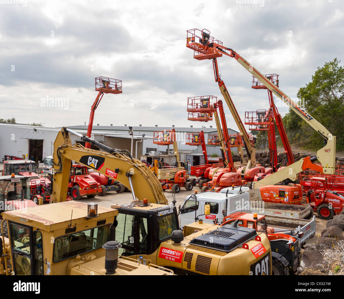

There's a hire depot near me and they always leave the cages extended. Maybe something to do with hydraulics?
