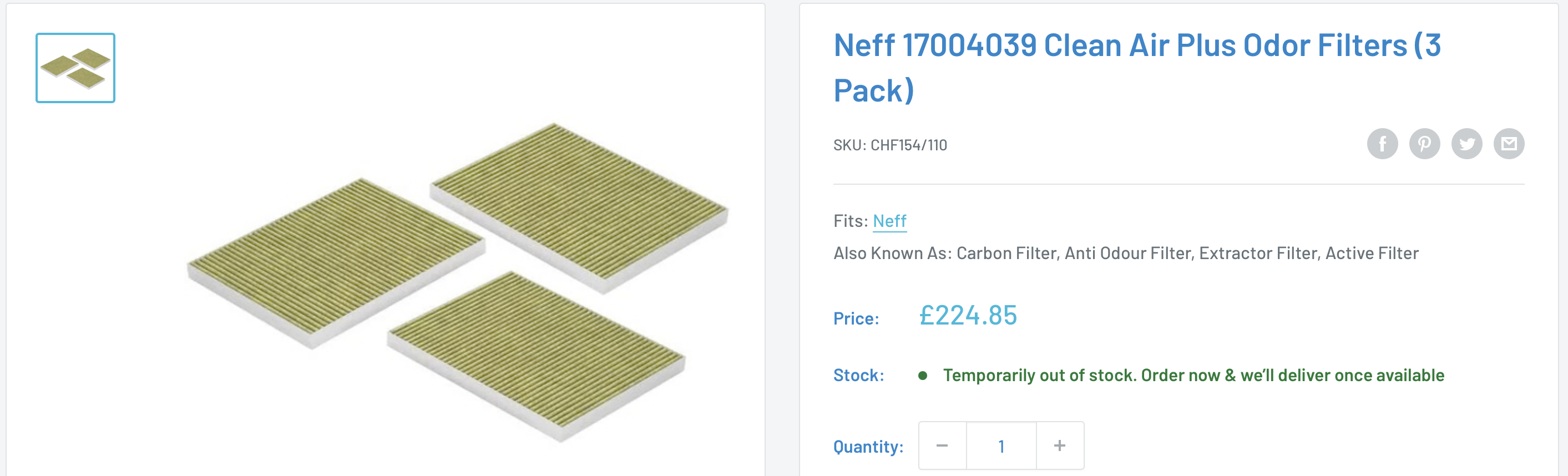

Posts: 4022
Posted by: robola
WTF, how often are you replacing those?
When it tells me based on usage. I can't actually remember how long that is as I switched to the ones that last about 10 years that you can regenerate by blasting them in the oven - a snip at £485 (think the RRP was around a grand 🤣).
