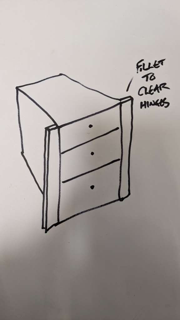

Posts: 17803
Very possible.
The easiest way really is to make a box of drawers that you then sit into the existing cabinet. It may even be that you can buy something that'll work with minimum mods from somewhere like IKEA.
The thing to remember is that when kitchen doors are open, they tend to sit inside of the outline of the carcass. This means that any drawers need to be a bit narrower than the carcass in order to clear the door and hinges at the sides when opened.
When I build drawers into cabinets with kitchen type hinges, I will usually use a filler trim to the hinge side of around 30mm which is usually plenty to clear.
Also remember that the drawer box needs to be shallower to allow for any handles on the drawers and that.
PXL_20240110_083418906
