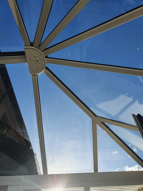

I like our Glass roof, needs a clean tho
