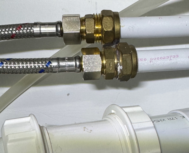

Clearly I struggled with this 10 years back as I've got a compression fitting on the 15mm plastic which I really don't like the idea of. You can do it according ot the Hep2O manual, but should use a copper (rather than brass) olive.  No idea what I actually did.
And it's clearly been leaking very slightly, for a long time. And it looks like I used some liquid PTFE to stop it leaking when I fitted it.  Which didn't stop it leaking.
So, whats the best way to rework this? undo that compression nut and put a load of ptfe tape on it? or use some different fittings?

The fitting you have is fine, I'd just undo the nut on the compression side and remake with fresh jointing compound between the olive and fitting and tighten up again. If that doesn't  work (unlikely);try with a new olive.

If it is the bottom/ blue pipe, and the leak is coming from the right hand nut, then just take it apart, clean it up, use pipe sealant, or liquid PTFE, and re-do it up. Or, better still, cut off a small section of the plastic pipe, re-do the connection with a new olive. I dont routinely use any sealant on compression fittings,and dont get any leaks. It’s possibly been tightened too much, so a new olive would be necessary, along with a small bit of the plastic cutting off. At most, 10 minutes and a new 15mm olive.

Might it be that you didn’t use a suitable insert in the plastic pipe? If it was the only compression fitting in the house I could see why you might not have had a box of metal inserts to hand

Do not use jointing compound on the plastic pipe. That is a simple connection you shouldn’t have any issues. If you use anything a couple of turns of PTFE over the front face of the olive.
Are you sure it is not leaking where the hose makes onto the brass adaptor, or even the hose itself?

Turns out it was the upper pipe leaking not the lower. So probably not tight enough, rather than the lower which I thought might have been over tightened.
