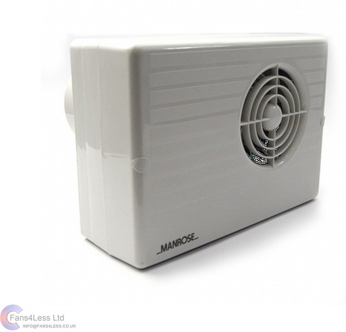

This is a centrifugal rather than axial fan and could suck an orange through a hose pipe. Becuase of that it tends to only run for shorter times as it excchanges the air rather quickly. I have these everywhere.
[url= http://www.ebay.co.uk/itm/MANROSE-CF200H-CENTRIFUGAL-EXTRACTOR-FAN-HUMIDISTAT-BATHROOM-CONDENSATION-/260872084620?pt=UK_Home_Garden_Hearing_Cooling_Air&hash=item3cbd301c8c ]ebay Manrose CF200H[/url]
You can also get the CF400H which could suck a melon through a hose pipe..
Posted : 03/04/2014 9:54 am
Posts: 3327
How noisy are they toys?
Posted : 03/04/2014 12:10 pm
Not quiet, bu not too bad, as centrifugal fans tend to be quieter than axial anyway.
Plus they don't run for long.
Posted : 03/04/2014 12:53 pm
