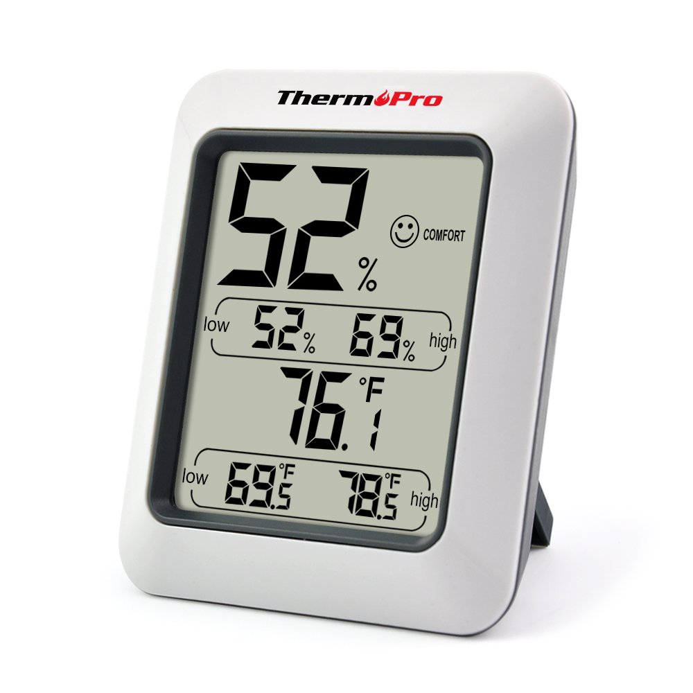

so this hygrometer say.......
hygrometer
it has a low and high humidity figure (52% to 69%) with a 'big reading' of 52.
what would that tell me? is it a range over 24 hrs or somethings and 52 is what it is now?
been looking at a few and theres a lot of complicated equipment with lots of readings, weather stations etc. i just want something that i can stick in a room and it says x% dont i? and move it to another room and itd take a minute or so to change reading to new room?
thanks

Posts: 8849
Re Hygrometer, I decided it was probs best to buy one that can be calibrated and buy a Boveda one step calibration kit at the same time. I think they say several hrs in a room for a proper reading, but IME you will see a change on the display quite quickly for an indication of roughly where things are at.
High and low are highest and lowest readings since your last reset /turned offon / took batteries out. main reading is current

Posts: 41395
t has a low and high humidity figure (52% to 69%) with a ‘big reading’ of 52.
You whould be able to find a manual that tells you by googling the model.
Posted : 31/01/2019 11:06 am
Posts: 7423
rightyo, thanks. ill go for somethings simple like that then. if i get any weird readings i believe i can check its effectiveness with the 'salt test', but it should be good enough to give readings of interest. only a tenner too.
cheers
Posted : 31/01/2019 11:27 am
Posts: 8849
rightyo, thanks.
Er, just occurred to me, that's what mine does, what you're looking at buying might differ. as cynical says, the instruction manual for make/model you're considering will almost certainly be online
Posted : 31/01/2019 12:03 pm

 myti
Posts: 1815
I have a very simple weather station like that and an extra probe. Right now it's 19 degrees and 53 humidity in my living room and the probe is reading 4.8 and 80% humidity in my fridge.

well the super-dooper pigeon-sucking fans up and running, and initial excitement soon turned to dismay....
moisture-meter in bathroom starts off at 64, lets see how much dryer it can get!!
64, 65, 66, 67, 68, 69, 70, 71, 72, 73, 74, then settles down at 71...... hmmmmmmm...... shurely shum mishtayk....
bathroom window was shut to make sure it wasnt just blowing back in, bathroom door opened a crack to simulate a vent in the door.... then it twigged. or at least i hope it did.
wife cooking sunday dinner, house a bit steamy, course.... its dragging the air from the house in isnt it! so the air its replacing is probably damper than whats in the bathroom.
so..... could it actually be an amazing fan, bring in all the air from the rest of the house? time will tell. moisture meter (hygrometer?) is being moved about for tests, the hall outside the bathroom is 71 so 71 in the bathrooms all you can ask for really.
its bloody loud tho, sounds like a jet engine warming up ready for the off, hope we get used to that.....
Posted : 10/02/2019 2:43 pm

Posts: 7423
Surely external humidity is as low as you can expect .
tried explaining this to my wife, the ideal can only be what it is outside. i stuck my meter out on the drive, it read 67%. only way of bettering that is dehumidifier i expect, but no point if the air around it is higher?
i must admit, after a bath/shower and the fan on for another 20 mins, the humidity has on occasion dropped into the mid 50s, but i expect its the same outside at that point too.
