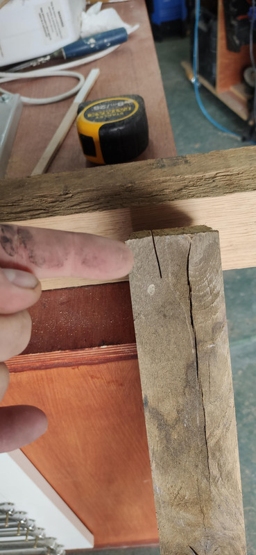

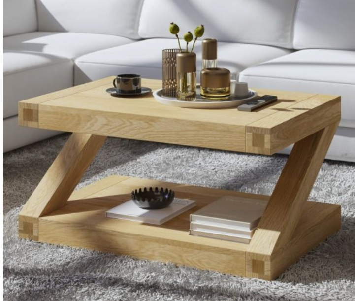

I want to try and make a coffee table similar to this:
From This
There should be enough oak to cut into slices and glue together to form the table top and probably bottom platform, if not, one of the other woods can form the bottom piece. Making the diagonal leg seems straight forward enough.
Who can suggest a joint between the leg and the top / bottom platforms?
The base can be glued and screwed, or whatever fixings, from below but the top deck is clearly visible so can only have hidden fixings or clever joints. Would a few dowels really be strong enough, I doubt it?
Any clever ideas from the experts on here please?
Posted : 12/04/2022 11:03 pm
Sliding dovetail. Cut the table end joint over long, then slide the support leg/arm(whatever) into place and use an infill piece to hide the gap.
Alternatively make it a through tenon, wedged.
Posted : 13/04/2022 12:24 am
That table looks like it would fall over if a drunk ant walked into it.
Through Tenon with nice contrasting wedges, keyhole joining system like This or just cheat and glue and screw it but sink the screws just deep enough that you can rout a pocket and inlay end-grain to make it look like a through Tenon (the cabinetmaking gods will strike me down! 😂)
If it's more about the journey than the end result, then I would aim for something on show like a through Tenon, perhaps even a twin through Tenon with contrasting wedges.
Posted : 13/04/2022 5:59 am
I'm with those two^
I have a shit load of padauk I can send you a wee lump if you like for contrasting wedges.
For what its worth thought i think Kayak is right, thats going to fall over, the base isn't nearly wide enough. I think you can come up with something better.
Posted : 13/04/2022 6:40 am

Thanks all. I think I will try for the contrasting tenons idea even though the thought of cutting something accurately scares me 🙂
I agree about the unstable look, it is what attracted me to it, and am thinking about how to make it work.
My first thought was a nice thick steel plate inlaid under the base, possibly with a couple of bolts welded on to bolt the leg to - top holes hidden with matching wooden plugs. This would add a lot of weight to the bottom of the table and should make it more stable.
I am hoping that making the leg out of a 4" square lump of timber will give me a nice large surface area for the joins to add strength and balance, especially when cut at an angle to further increase the contact area.
Basically, I want toi try something fun rather than safe. I am doing this for the joy of the making process as much as the end result. This really is me playing rather than you guys producing something.
JoshVegas - Thanks for the offer of wood. I think I will risk my cheap stuff before raiding your stock but I reserve the right to pester you again in the future. Are you based anywhere near Southampton?
Posted : 13/04/2022 8:50 am

There is a reason the prop guy put books on the bottom of that table!
If someone really wanted that I would use a mechanical fixing then a contrasting timber inlay strip. One drunken night and that table would be back with me broken.
Look at some of the 70s habitat stuff for design ideas thay made some nice coffee tables.
Posted : 13/04/2022 9:08 am

I might modify it so that it has the slim, light design of the first but the Z is turned 90 degrees to reduce the forces and leverage. A bit like a light weight version of this
Posted : 13/04/2022 10:27 am

Hmmm, that one looks like it has been designed to look complex but the basic design isn't too difficult as you have the three big runners under the main table to fix stuff to. Might try to incorporate that
First task is for me to make some planks. I will add photos to this thread as I go in case anyone is interested.
Posted : 13/04/2022 11:00 am

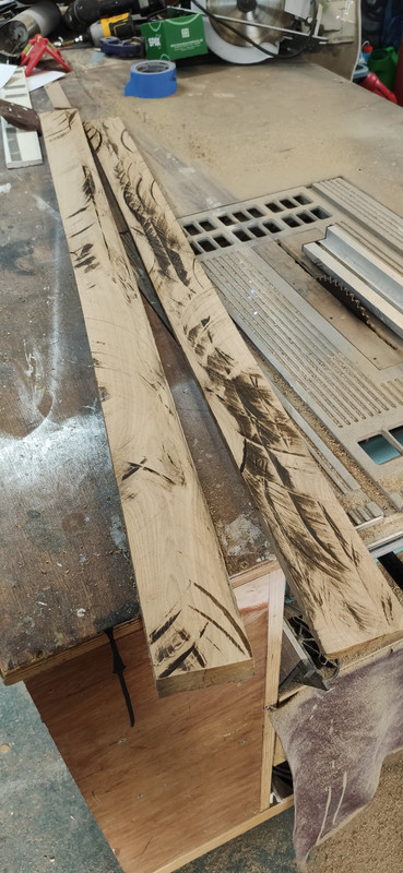

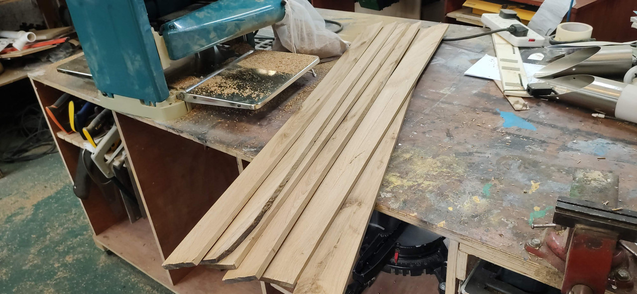

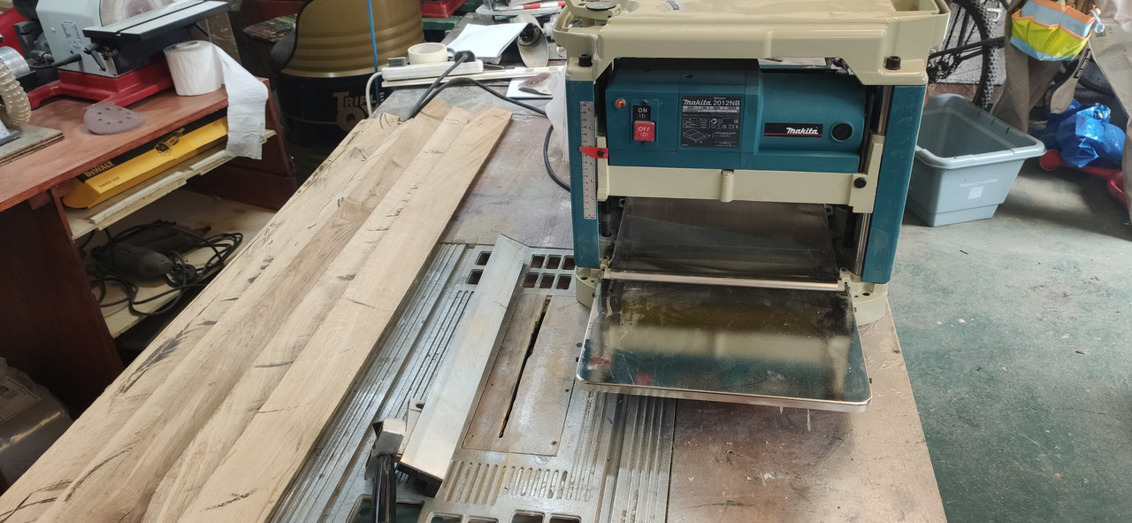

I have started the process.
1) Get some wood and hope you can slice it with a chreap crap band saw
2) Okay, that wasn't up to the job
3) The table saw looks almost big enough for this
4) It took about 3 blade heith increases to get here because the wood is harder than the useable cheap pine I use.
5) Hmm, Might need to see if I can reduce the burn but once through the thicknesser plane, no-one should notice. Now just got to do the rest.
Posted : 13/04/2022 11:57 am
Yikes, no riving knife 😯 Plus too many teeth for ripping. Looks more like you've a cross cut blade on there.
Last time sharpened/cleaned ?.
Posted : 13/04/2022 12:06 pm

Time to hit pause and sort out your tools before you lose a finger.
First preference for this operation would be the bandsaw. What’s going wrong there? Maybe we can help fix that.
If you’re sticking with table saw:
You need a lower teeth count and sharp blade.
You need a riving knife fitted.
You need the fence fitted the right way up - there’s not enough height in its current setup.
Pushing timber through a blade that’s struggling is how accidents happen. With the correct sharp blade it should glide through (ish).
Posted : 13/04/2022 12:21 pm

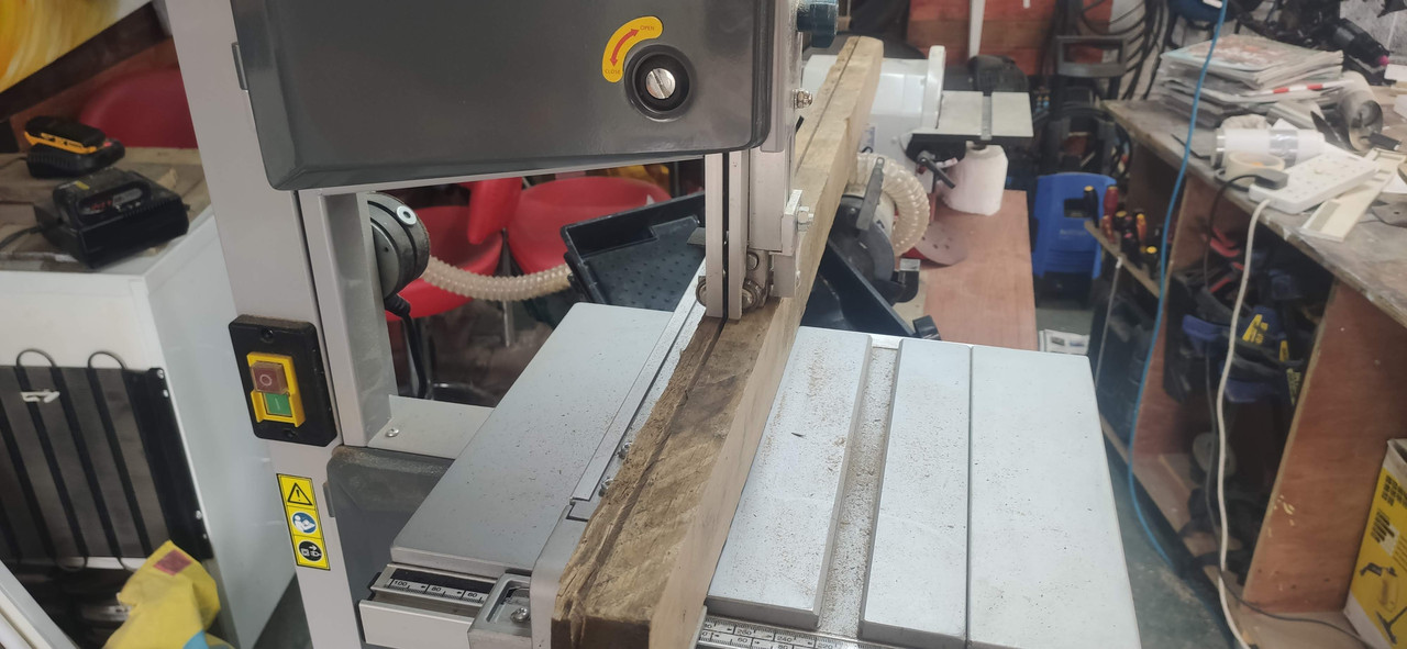

3) I thought I would try with the blade I had before buying a new one. What do you mean by clean and sharpen 🙂
4) Band saw is an Aldi special. The guide rollers will not stay fixed close to the blade and the blade can't be tensioned much without falling off the main wheels so regardless of how slowly you move the wood forward, the blade bends to one side or the other, seemingly randomly choosing which direction

Regarding the bandsaw
the blade can’t be tensioned much without falling off the main wheels
Sounds like the wheels need aligning. There’s videos on YouTube.

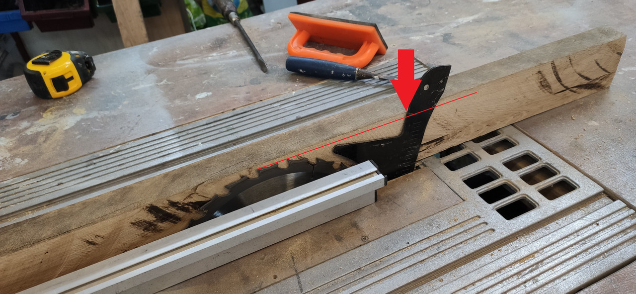

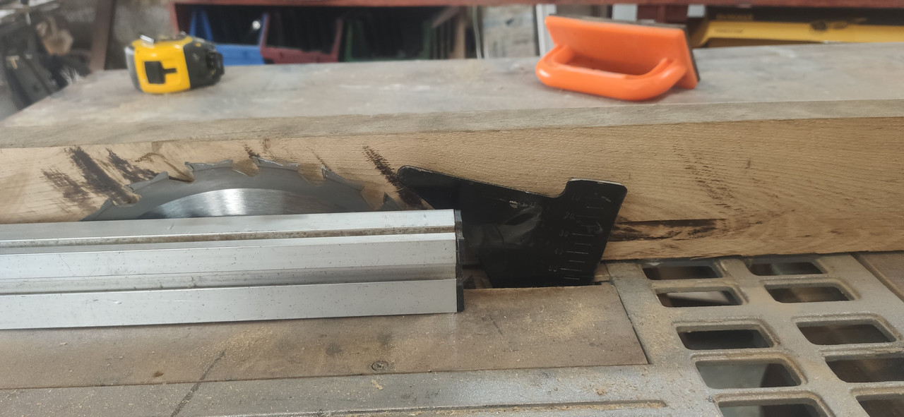

Posts: 13369

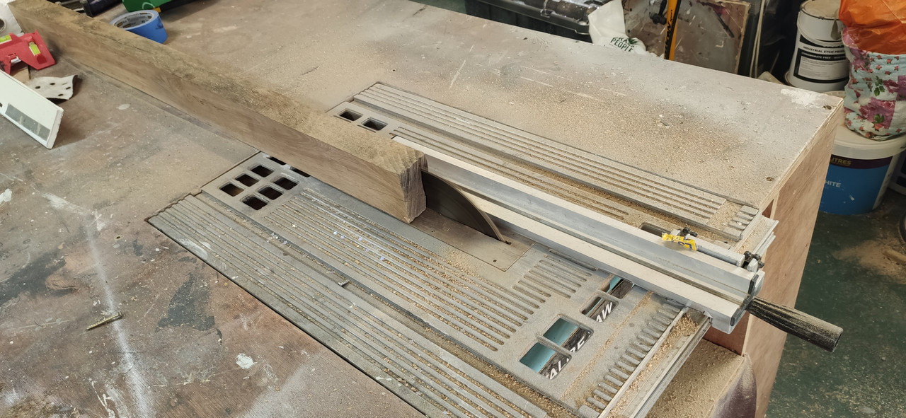

Okay you "health and safety gone mad" lot, what now?
1) I used a tape meaure rather than guessing the blade size
2) I got the 24 tooth blade as recommended
3) I refitted the riving knife that came with the table
4) I even got a bloody pusher thing that has been kicking around the tool shelves since someone bought me it from a Christmas pressie
Obviously I can't actually do anything now because the blade doesn't cut all the way through the wood so it just hits the riving knife and stops so what do I do?
My first thought is just to grab the angle grinder and cut the top off the riving knnife but I am guessing it was there for some reason so what do you suggest?
[i]Sounds like the wheels need aligning. There’s videos on YouTube[/i] - Quite possibly. One to look at for the weekend I think.
Posted : 13/04/2022 5:07 pm

The sticky up bit on that riving knife will be to fit a crown guard to.
There isn't much you can do with that type of design really.
If you butcher it, you won't be able to fit a crown guard which you ought to have on there 99.9% of the time.
Unfortunately it's that sort of knife design that prompts folks to remove it completely and then have accidents.
There are designs (like the one that is fitted to the Hammer table saw in our workshop) that allow the fitting of crown guards AND are still in line with the top of the blade.
You don't have that.
There are two main adjustments on a bandsaw. Tension and tracking.
Tension moves the (usually top) wheel up or down to put tension or slack on the blade.
Tracking tilts the top wheel fore and aft, so that you can get the blade running on both wheels without falling off.
It's very like a belt sander if you've ever used one where the belt goes off the rollers one way, but you make an adjustment to centre it.
Same sort of thing.
It's very likely that the blade you got with the bandsaw will be garbage.
It's important to set the guides so they are Rizla paper close on both sides, just behind the gullet of the teeth, and the 'Thrust wheel' behind the blade.
The thrust wheel (sometimes a solid block or rod of metal, sometimes a bearing) should be Rizla close when running, but the blade will touch it when under load.
To be honest, you're probably asking a bit much of an Aldi bandsaw. It'll have a maximum blade size that probably won't be wide enough to cut thick hardwood like that.
If you've tried to cut it with a small blade, then wandering of the cut is fairly inevitable I'm afraid.
Try a company called Tuffsaws..I just got some blades off them that seem really good.
They're very helpful if you explain your issues and what you're trying to cut.

Order a spare knife and butcher that one they are a terrible design and aways makes people take the crown off..
You can take the knife off and place a wedge into the timber cut to stop it binding BUT that's a two person job and they both have know what they are doing tbh.
Do you have a skill saw?
Mdf straight edge with blocks the same hight as the timber then cut in 20mm passes lowering the blade.
Also you could make jig to cover the saw blade then push the timber through the table saw cover the blade in a box to stop you getting pulled into the blade.

Posts: 13369
There is no 'crown guard' and never has been since I have had the saw so I couldn't fit it is I could. The knife is just a piece of thin painted steel held on place with a single Allen bolt just behind the blade inside the saw 'box'.
I assume trimming the knife just below the red line would allow me to use the saw and still get some of the safety benefits. Please let me know if this isn't the case as it is getting cut in the morning.
The band saw is simple enough and I understand the basic principles on getting the wheel alignment right and then using the tension to pull the blade into place. The trouble is that all of the adjustment bolts etc are so coarse and clunky it is almost impossible to set up correctly. The back roller is held in place with a single 10mm nut but for the top runner it is fixed to the saw chassis and can be rocked backwards and forwards about 1-2cm with easy so offers no real use.
Short video showing the (lack of) rigidity and alignment :
It currently works okay on 6mm ply which I was playing with but the oak was more of a challenge. Once I sell some more paintings or sculptures I will possibly use the money to buy a proper saw. I have promised myself to fund my hobbies from what I sell for a while otherwise I could get silly with too many toys and not enough time to use them.
Posted : 13/04/2022 9:59 pm
The riving knife should be a smidgen thinner than the blade kerf.
Make a short cut, measure it then measure the thickness of the knife. Other than that it could just be a case of shimming the knife so it sits directly int he middle of the blade.
Posted : 13/04/2022 10:05 pm
Posts: 13369
dyna-ti - The knife I have is the right width and place, just too tall when I don't cut right through the wood. In the photo above the red line shows the top of the cut so the top of the wood is not touched and when that hits the top of the knife I obviously cannot cut anymore. The plan is just to cut the top off the existing knife and hope all is well.
Posted : 13/04/2022 10:09 pm
Righto.
That would be normal. My knife sits about 8mm below the top of the saw,which is fine for most tenons. Could be a little lower ideally.
It should though sit between 3-8mm clearance at the back between the saw blade and the leading edge of the knife. You dont want too much or the timber has room to close before the knife does its job. But height wise, 8-10mm is good
Posted : 13/04/2022 10:43 pm
 pk13
Posts: 2727
If you don't have the crown gaurd just cut it in half. BUT usual warning applys
Posted : 13/04/2022 11:54 pm
Posts: 1831
Sounds like the wheels need aligning. There’s videos on YouTube – Quite possibly. One to look at for the weekend I think.
Yeah I nearly said earlier, it’s one of those jobs where you’ve got plenty of hours spare and plenty of patience 🙂
If you don’t have the crown gaurd just cut it in half.
Yeah I’m thinking this. Fetch the grinder.
But, of course,
Slowly, slowly, WCA, we’re gonna reform you into a health and safety guru!!!
Posted : 14/04/2022 12:04 am

More photos to follow
Posted : 14/04/2022 7:29 am
Posts: 13369
Modify the Riving knife so I can actually use it
Even with most of the cut done and a new blade from Axminster the crap band saw struggles to cut with the saw slowing right down if I move with any speed. I can see that being ignored for anything thinker than ply in the future
Anyway, here are the rough planks with burn marks and saw circles galore
And here they are, much wood shaving later, with clean sides and faces. Still need the final cut but I think I will need to cut a few more planks to make the table size I have just been told we now want. This will also alter the design ideas.
Posted : 14/04/2022 1:11 pm
Whats the tooth count on the bandsaw blade ?. I use 3tpi which is really good for ripping, and the last ripping job i did on it was 160mm maple, which it handled with ease.
I think the motors on my small 10" bandsaw(record power) will not be dissimilar to yours, so maybe just keep the feed speed down , afterall its not a sawbench so feed speeds wont be fast as that.
The finish you've got on the cut looks pretty clean, and certainly better than the horrific burn marks from your sawbench.
Next wee job for you to make yourself is a drum sander. Got a lathe ?. Plenty of easy to construct drum sanders on YT.
Posted : 14/04/2022 2:51 pm

Posts: 13369
[i]The finish you’ve got on the cut looks pretty clean,[/i]
The clean cut is after the thicknesser. It was going to take about 15 minutes per length with the band saw so just switched to hand saw to cut the rest
Don't have a lathe (yet) but will probably be upgrading my table saw and bandsaw before I do. Table saw it okay at cutting but the fence won't stay parallel and it is hard to get a good parallel cut without that
Posted : 14/04/2022 5:58 pm
