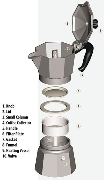

I've had limited success with one of those stove top affairs, this type....
Tried this morning again & all that happened was the coffee in the container got wet. I'd tried earlier with just water & it boiled nicely & bubbled up into the top. I filled the coffee container to the top (level & didn't tamp it down) stuck it on a steady heat & waited. & waited. In the end it was steaming away but nothing was coming up to the top.
put me right before I waste anymore coffee or revert to the cafetiere again!
EDIT, mines not that big!

Filled it too full over the valve? Valve blocked?
Seal between the two halves broken?

I'd guess the seal is not sealing....they get hard with age and leak. Also make sure the plate that the coffee is forced through (which the seal sits on) is the right way up

Grounds spilling over onto seal? Will stop a good seal from forming.

Does the seal look ok at the bottom of the top half and the holey filter sits right? I've got 2 sizes of stovetop and they're both fine with espresso grind btw.

The more I think about EGF's issue, the more I'm confused as to how it's physically possible to have steam coming out of the 'chimney' and not coffee, without steam also escaping from elsewhere. Even if the coffee was so fine and tightly tamped that it was blocking the chamber, it should blow the pressure valve.
First principles then:
[list]
[*]Fill lower chamber with water, to just below the pressure valve (I boil it in the kettle first simply because it's quicker).[/*]
[*]Put the coffee hopper in the chamber.[/*]
[*]Add coffee. This should be a fairly coarse grind. Fill it almost level to the top, don't tamp it down at all, and ensure there are no grinds on the rim which might cause a poor seal. [/*]
[*]Screw on the top chamber, tightly (I use an oven glove to hold the bottom as it's hot!)[/*]
[*]Put it on the hob and turn the ring on. I use the smallest ring on the highest setting. If it's a gas hob you may need a [url= https://www.amazon.co.uk/d/Shops/KitchenCraft-Galvanised-Iron-Gas-Ring-Reducer-4-5/B0001IX10M ]reducer[/url] ring.[/*]
[*]It should start bubbling away quite quickly.[/*]
[*]As soon as the water looks to be turning to steam, remove it from the heat or you'll end up with bitter coffee.[/*]
[/list]
A word on the upper chamber, there's three parts to it (four if you're counting the lid). If you carefully remove the rubber seal, it'll release the filter. I'd check both of these are clean and clear before you start. When I got mine it took me a while to stumble across this.
EDIT - like this:

I would have thought the only way steam could come through the chimney without coffee is if the seal was completely gone, and the steam came around the basket and up
Posted : 22/07/2017 12:52 pm
Quite.
My OH once used ours without the seal and filter (I'd stripped it to clean it and she hadn't noticed). Net result was it pissing boiling water out of the sides.

*SORTED*
Did exactly the same as before but screwed the top & bottom together to 32ft/lbs with a torque wrench.*
*not really, just probably tighter than last time.
The seal looks absolutely fine & the valve seems ok too. At least it's working! Thanks for the replies. 😀
