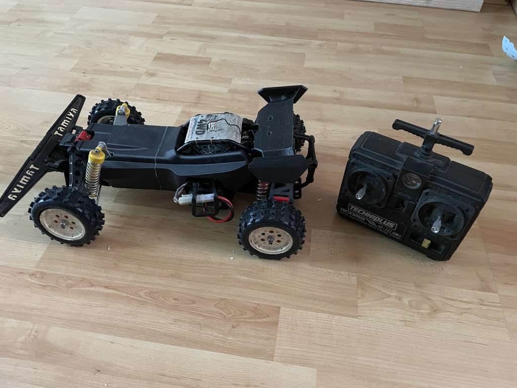

Currently in the process of rebuilding this:-IMG_1123
Posted : 22/12/2024 2:09 am
Posts: 3480
It was given to me about ten years ago, missing its front drive shafts and knackered tyres. It looked like it’d been run over.
I put a battery in it and proceeded to crash it within 15secs, breaking an upright.
So in a cupboard it went.
Yesterday I found it and decided to see if I could sort it out.
I stupidly left the batteries in the Acoms radio, so they leaked. One of the contacts then snapped. I’ll see if I can fix that or get a modern radio maybe, although the quick fix up is getting costly fast.
I actually printed a new upright, then as I pulled it apart I found a few more broken bits and just ordered a pair of new uprights anyway, plus rear wish bones, rear carrier, driveshafts, another battery, tyres and other bits I can’t remember.

Modern electronics are so much better and a lot cheaper than things used to be
I’m thinking a radio that doesn’t require 8000 AA batteries would be nice. Don’t want to spend much as it won’t get used a huge amount.
Would a modern speed controller allow for a more usable speed range, rather than almost flat out, flat out and backwards?
Yes. I use the bog standard Tamiya kit ECU and they are great for very little money. Lots of model shops sell cheap new take ones taken out of kits where someone is running a hot motor. May as well get a new servo as well while your at it.

Looks like  HotShot 2 with the Supershot front suspension upgrade?
Posted : 23/12/2024 11:14 am
Posts: 3480
I’m not sure. It’s a Hotshot of some description, I’d assumed a 1.
I’ve stripped it down to check the 4wd gearbox, thought it was broken, hence the missing prop and driveshafts, but it looks fine.IMG_1126
Posted : 23/12/2024 4:45 pm

I think it's a Hotshot 2. The original hotshot had mono shocks front and rear and the Supershot upgrade gave it front shocks like yours mounted to those alloy towers and matching yellow ones mounted behind the suspension arms instead of in front.
Nice motor on that too. Hopefully it's got full ball bearings in the gearboxes etc?

I think it’s a Hotshot 2. The original hotshot had mono shocks front and rear and the Supershot upgrade gave it front shocks like yours mounted to those alloy towers and matching yellow ones mounted behind the suspension arms instead of in front.
Nice motor on that too. Hopefully it’s got full ball bearings in the gearboxes etc?
Ta, useful to know. I’ve never tinkered with a proper RC car before.
There are some bearings in the front gearbox. Not opened the rear yet.
The prop input seems to be a cream coloured nylon? Bush.
Obviously ordering a new prop  I didn’t realise I needed the cups at each end.
The hubs are all bushes.
Is it worth changing to bearings?
The bracket from the roll cage to the spoiler is mia, as is the driver.
Posted : 24/12/2024 2:31 pm
Posts: 259
If you're going to do a full restoration then yeah I would upgrade to bearings. Modelsport etc. sell them. Tamiyabase or Tamiyaclub are a good resource for the old manuals and from them you can identify which parts trees you need to order for the missing bits. I did a full restoration on my original Hotshot, added bearings and a super nice motor + new electronics + batteries and it ran beautifully. And fast!
Posted : 24/12/2024 2:44 pm
jamesoz and jamesoz reacted
Posts: 3480
Thanks I’ll take a look, it started as get it working, but mission creep…
I think you’re right it’s a two, from what I found the brass bit on the front gearbox and the front of the chassis are a identifier.IMG_1127

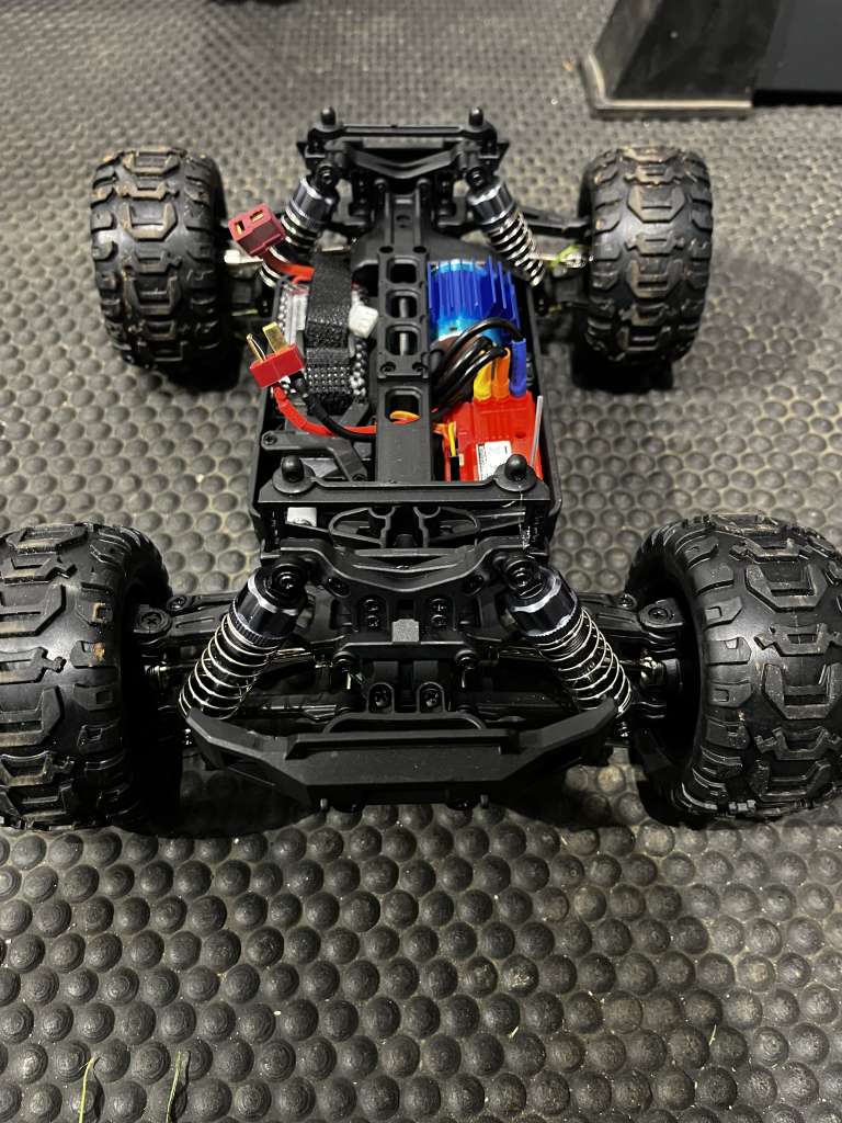

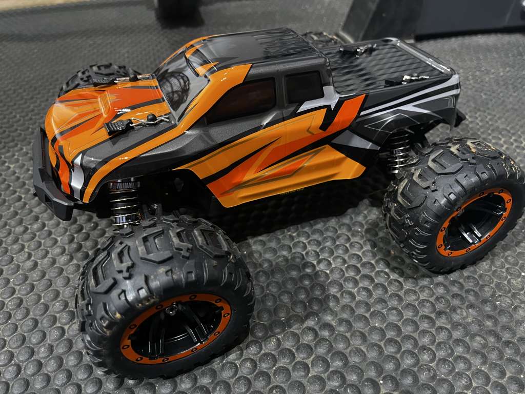

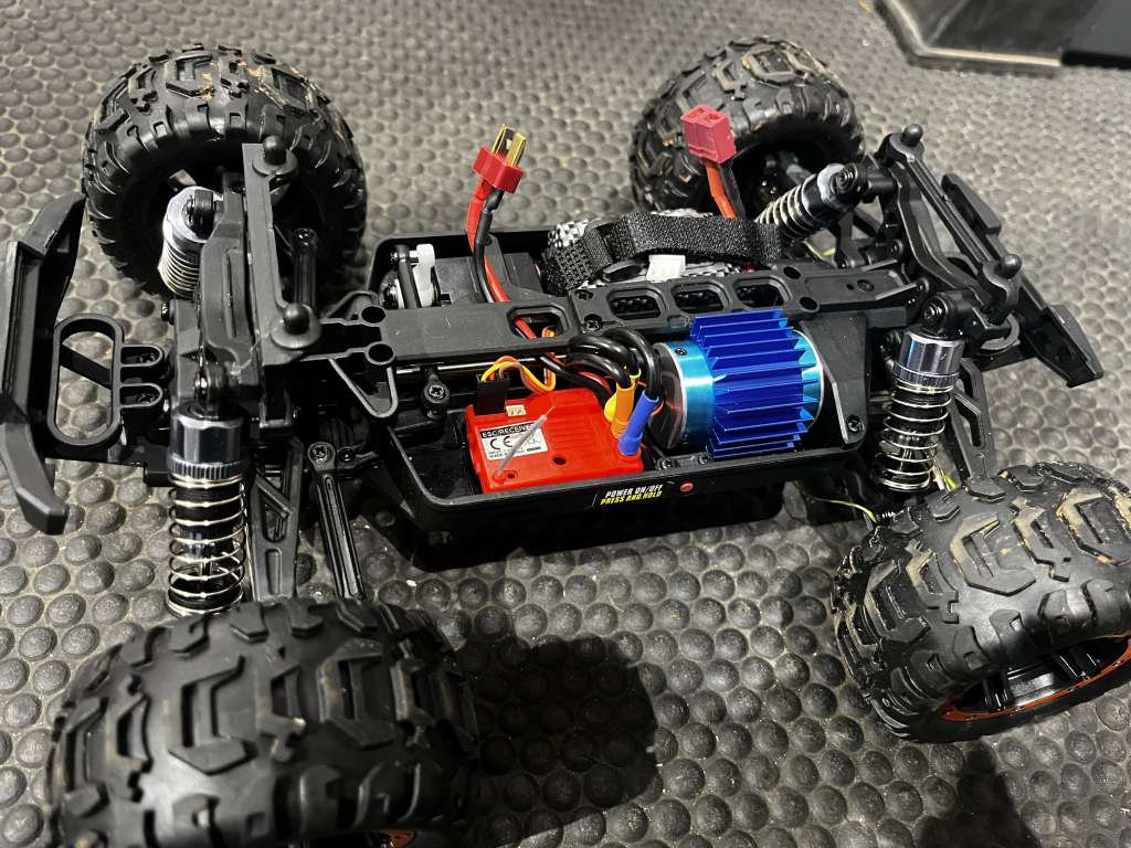

Got the HBX 168890a Pro - had a quick go on it in the garden. Triumph of power over handling and grip and it wants to roll over when cornering. I think the suspension is too soft and it lurches over and then digs in.
I think ideally it would have stiffer springs but hard to identify what to fit - so ordered some 35wt shock oil to put in. It feels like there isn’t as much oil as there could be in the shocks from new. There is some damping there (certainly better than friction shocks) but it’s not enough. See how we get on.
Overall it’s decent for the money though - motor seems really powerful and the kit all seems finished nice enough. I think I prefer the look of the truggy version so I may pick up that body / rear bumper / wing and convert it at some point. I think if rude is made lower it may handle a little better in the corners too.
Need to pop to the local pump track and have a play there at some point.

Thought I’d add a few photos of my recent purchase:
IMG_7280IMG_7281IMG_7282
I can’t get over how small the battery is tbh.

it's alive, it's alive!
All thrown together and using some bits borrowed from the child of a friend it runs. Now to paint the shell and decide if upgraded parts are on the menu.

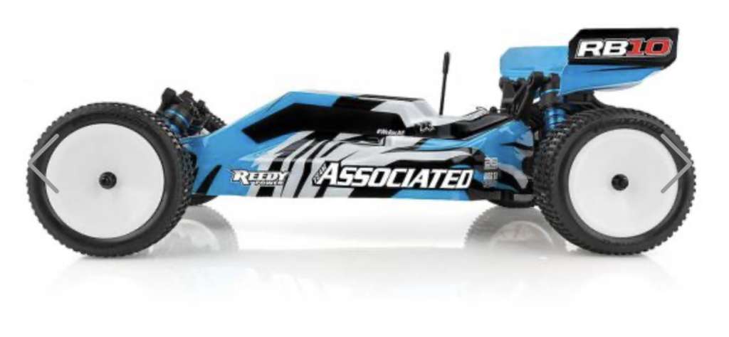

Just agreed a sale of my HBX16889a Pro - it’s blindingly fast but fancy something that handles a bit better / is less skittish.
Ordered one of these and have a 3s battery coming for it:
IMG_7422
Assume it’ll be suitably rapid (not for racing though as it’s rear motor).
