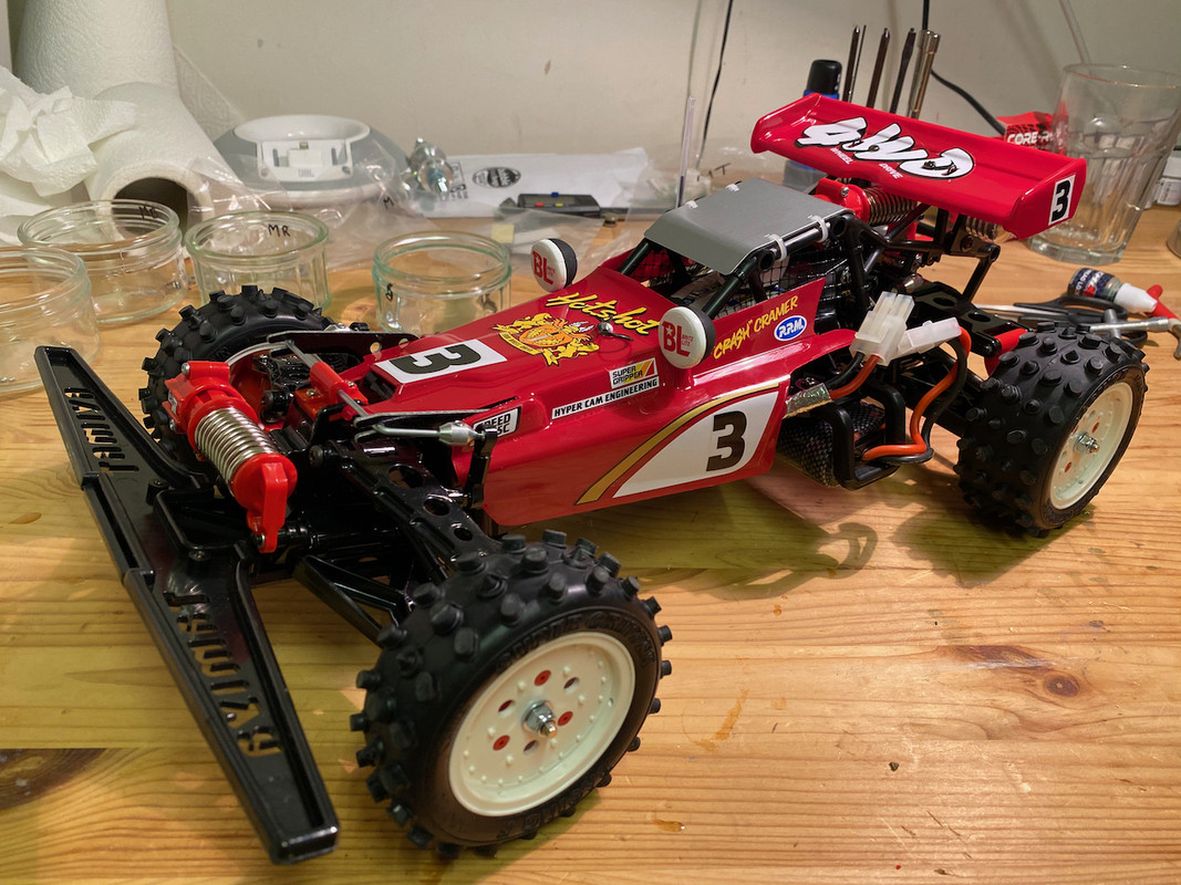

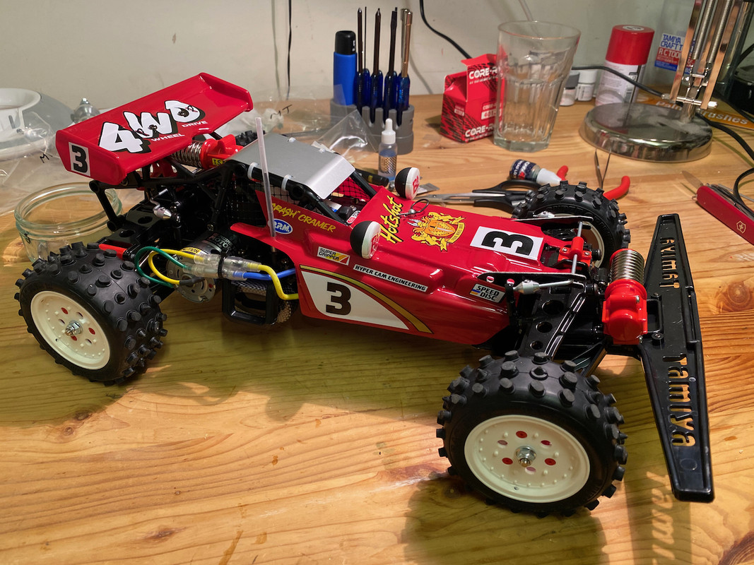

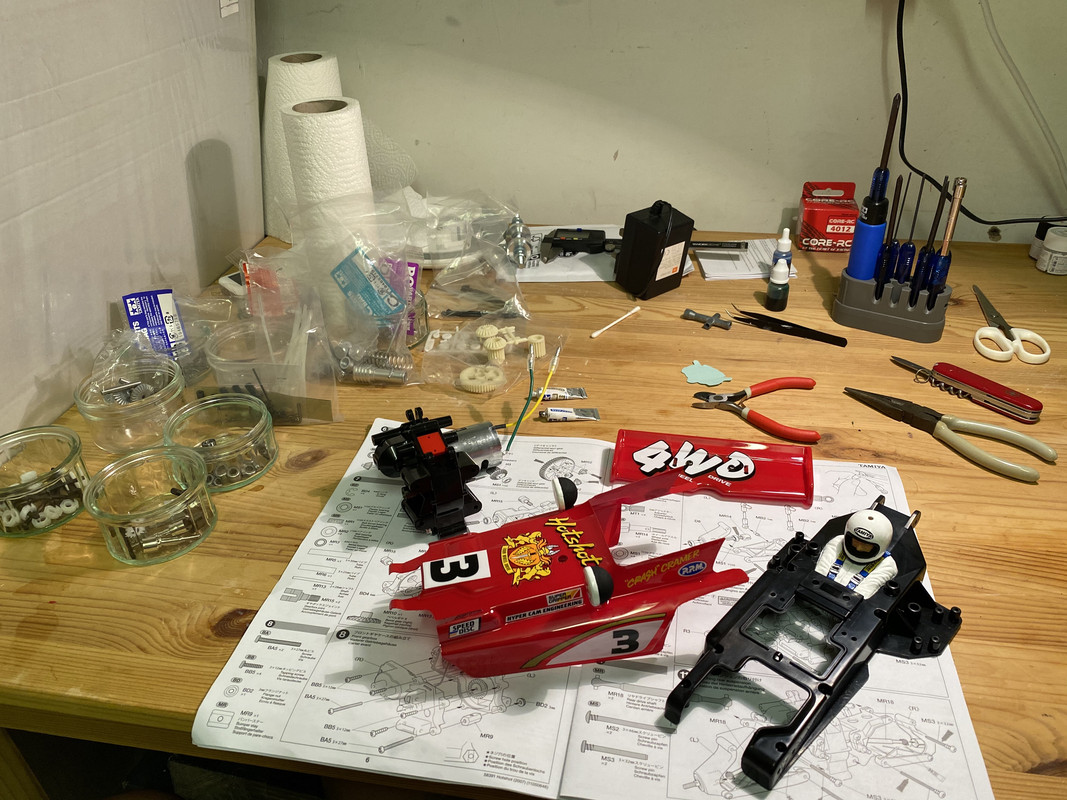

Posts: 3955
Coming along slowly, which is fine by me...
Couple of questions;
- I have a choice 13 or 15 pinion in the box. How to choose? Standard 540 motor. I went smaller as I thought slower = better to get used to the handling, but maybe more torque is bad on that front?
- I’m getting the impression I should have loaded the diff up with thicker grease for a poor mans limited slip? What quantity are we taking? I’ve got a big tub of Slick Honey - is that thick enough?
Posted : 21/05/2020 1:48 am

Posts: 3955
Think this got lost above so cheeky repeat;
I have 13 and 15 pinion options in the box. How to choose? Advice?
Hotshot with standard 540 motor
Posted : 21/05/2020 11:58 am
Posts: 6091
A qiick search seems to suggest the 13t for standard motors?
I'd assume they supplied the 15 for racers at tracks with longer straights?
Posted : 21/05/2020 12:09 pm
Posts: 1790
Mine has mounting holes for 17 or 19. Came with a 17 but now fitted with a 19.
With Torque Tuned motor it’s easier to control on loose surfaces from a standstill and a bit of extra top speed. Less fun for messing around on loose surfaces.
Try both. Not sure about your kit, but only a 5 minute job on mine.
Posted : 21/05/2020 12:38 pm
Posts: 3955
Cool, had fitted 13 as that seemed most appropriate from little I could find.

Posts: 3955
Coming along...
Posted : 25/05/2020 1:21 am
Posts: 3955
Just plumbing in the electrics. The antenna seems incredibly short. It’s going to come about half way up the antenna pole. Is that as expected or am I meant to extend it myself?
Posted : 25/05/2020 1:52 pm
If you use 2.4ghz the aerials are generally much shorter than for the old 40mhz and 27mhz receivers
Posted : 25/05/2020 2:01 pm
Posts: 3955
It’s 17 cm (~6.6”), which sounds more than it looks on real life!
Posted : 25/05/2020 2:08 pm
Which sounds fine for 2.4 ghz, but too short for 27mhz or 40mhz.
Is your radio 2.4ghz?
Posted : 25/05/2020 2:18 pm
Posts: 3955
Yes it is 2.4 ghz. Must be right, just going to look very silly to my old school eyes I guess with only 4 inches sticking out.

Posts: 3955
And we are done.
