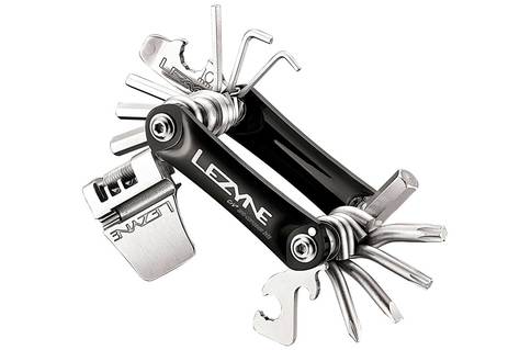

I mean a proper bike multitool - you know, with hex keys and useful stuff for out on the trail. (And that don't cost over £30!
Like -
Can't be too hard to design a mini version of what Cheeaybeanz posted to incorporate into one..
