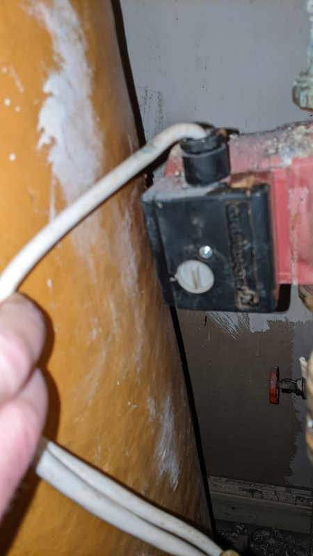

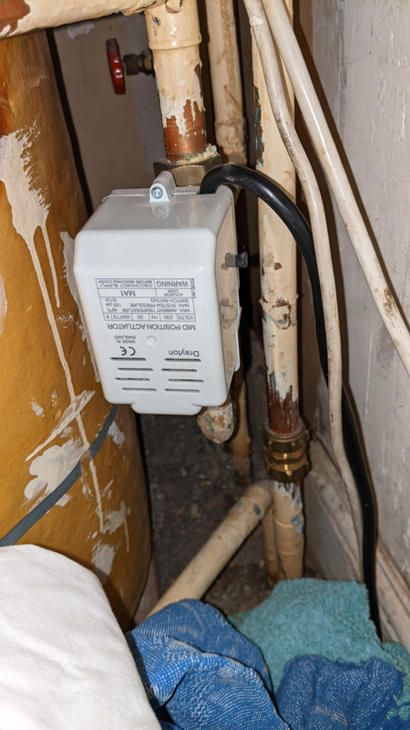

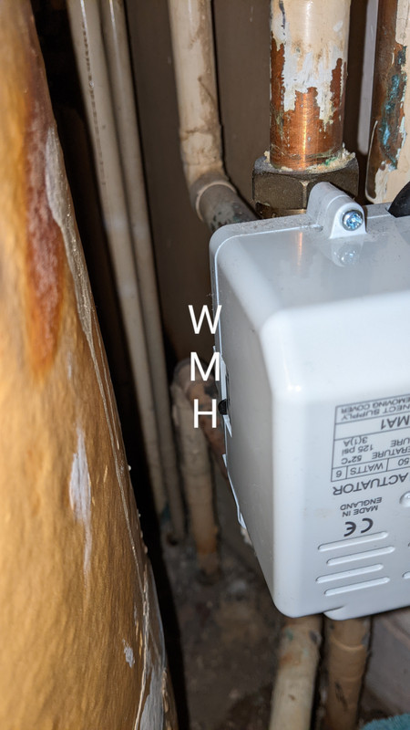

Just bled all the rads… one I realise after I hadn’t turned off, but everything’s the same after turning heating back on and opening a downstairs rad. No noise of it filling/heating up. Boiler fired up and went off again, so that safety/overheat is a definite possibility. Just gonna have to get a man in, I’m too useless to sort this out.
These are the boxes on the pipes in the airing cupboard
has WMH down the left side with the switch (which doesn’t budge) on H
and this, the white thing turns anti-clockwise 90deg
The first one may well be the motorised valve for the hot water (the cable would probably go to the thermostat on the cylinder and/or to your CH programmer).
The red one looks like the CH pump.  Make sure that is running - you can usually feel a slight vibration when it is.

Y plan system I think looking at the pictures.
Suspect the 3 position valve is stuck. Hence why it overheats and switch itself off , and you can't move the lever.
You could try popping the grey cover off , it's live so isolate it first. Pull out the motor and see if a set of adjustable spanners will move the valve . However , even if you get it moving there's still the possibility the synchro motor has burnt out.

You could try popping the grey cover off , it’s live so isolate it first. Pull out the motor and see if a set of adjustable spanners will move the valve . However , even if you get it moving there’s still the possibility the synchro motor has burnt out
The whole actuator (MA1) lifts off the 3-way valve without having to disturb any of the electrics, that tab on the right is a quick release. Push it in, pop off the plastic box and you'll see the spindle the synchronous motor moves and you can turn that as required. If that get a flow going through the heating circuit then I'd suspect the actuator has failed, though it's probably just the synchronous motor that's gone.
£20 for a new motor, £60ish for a whole new actuator including the motor. Amazon will do the actuator complete with valve for £61 which seems bizarre to me but you can just use the actuator and keep the valve as a spare, though tbh they rarely give problems unless you're in a hard water area or run the system without an inhibitor. Either way there'll be some mains off wiring to do but it's easy stuff, no plumbing involved.

By the way OP, just on case you hadn't figured it out, the little tab with W M H is just an indicator, the manual override is on the end opposite the screw. They can still be a bugger to move if the actuator has failed but the system is powered up and the motor's working against you.
