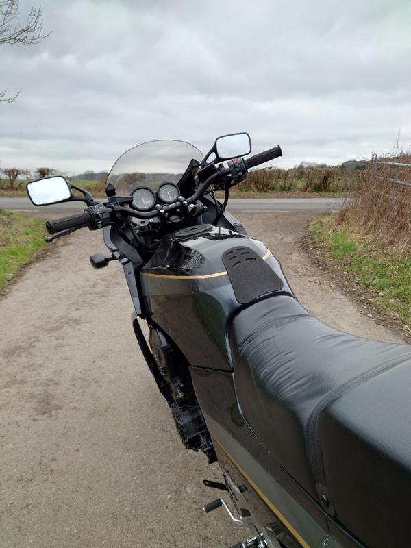

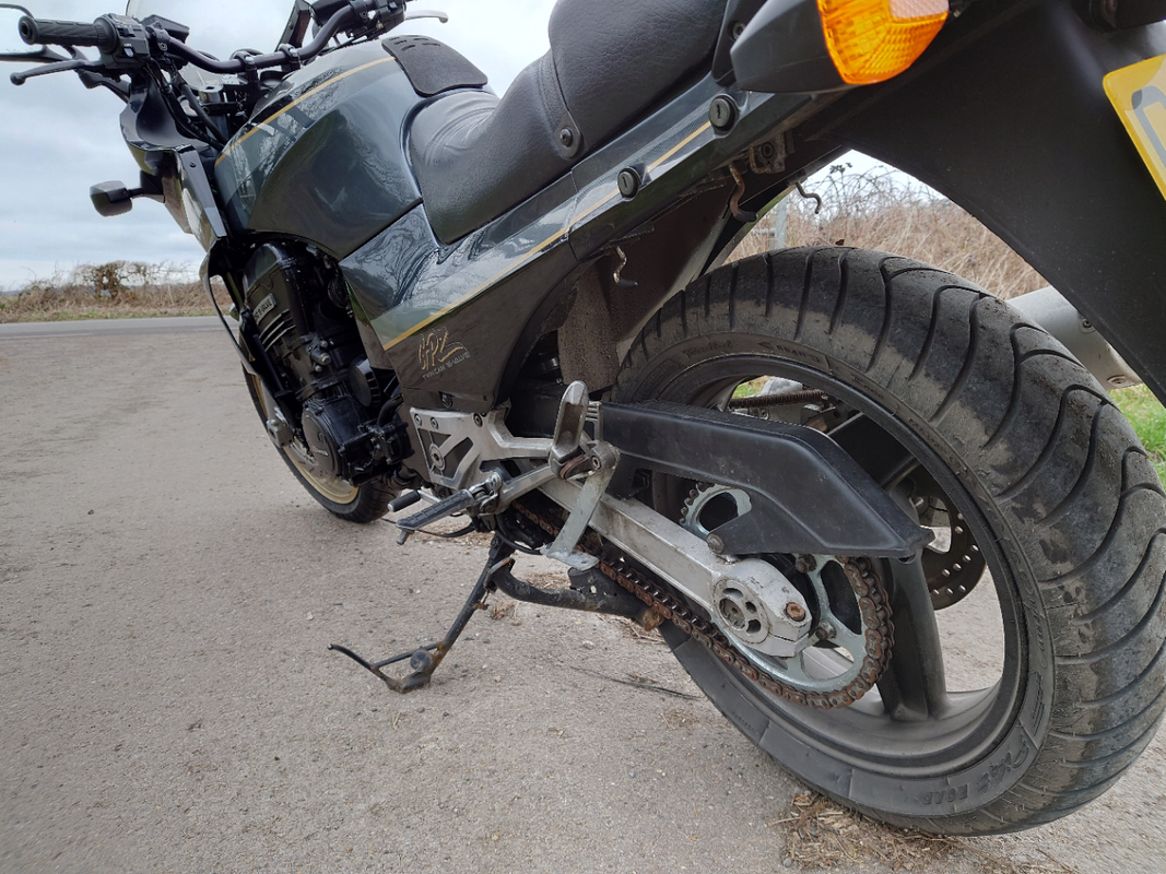

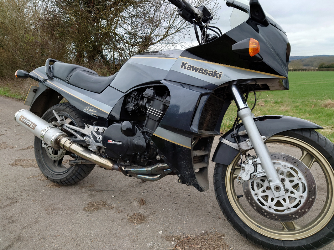

Can we have a picture of the bike please.
Posted : 04/03/2023 11:28 am
 Aus
Posts: 1522
1
2
3
Posted : 04/03/2023 2:33 pm
