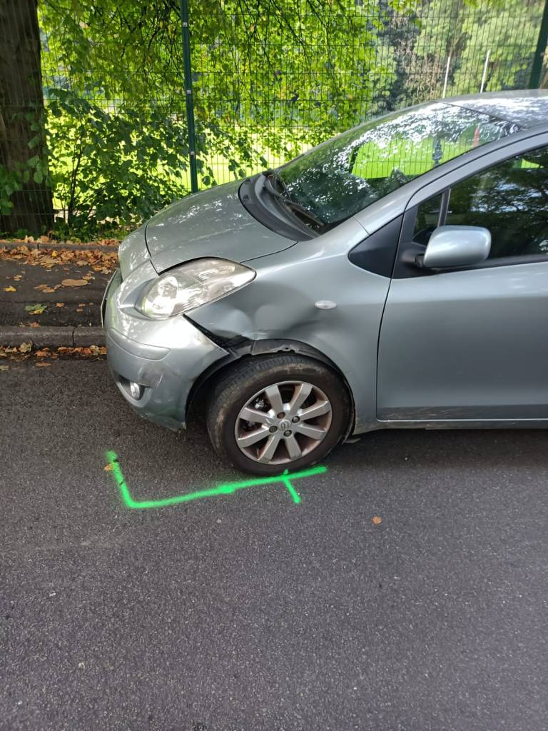

Posts: 8177
IMG-20230915-WA0003
Posted : 26/09/2023 11:30 am

Posts: 8177
It doesn't look like that now, we've pulled out the panel and made sure everything is attached.  There's no wheel or suspension damage (arch liner makes it look like wheel has moved)
Posted : 26/09/2023 11:33 am

Posts: 15068
I'd probably get it mot'd as it doesn't look roadworthy.. Appreciate you've pulled the panel out etc, but just to cover your back.
There could be damage /play in the suspension mounts/components, for example.
Posted : 26/09/2023 11:49 am
Posts: 16346
Possibly the only thing that might make it not roadworthy would be sharp corners. We had an old van that failed the MOT on that, but it was "fixed" with gaffa tape and then passed.
Posted : 26/09/2023 11:50 am
I'd not be driving that. Wheel looks like it's been pushed back as it's far too close to the wheelarch.
Posted : 26/09/2023 11:52 am
Posts: 15068
Wheel looks like it’s been pushed back as it far too close to the wheelarch.
Might just be the angle, looks worse due to the fallen arch liner, but agreed it needs to be checked properly, easiest way to do that would be put it through an MOT.
Posted : 26/09/2023 11:59 am
Posts: 13916
This...... doesn't look right at all!
Posted : 26/09/2023 12:01 pm
Posts: 632
IMO, an MOT won't tell you whole load about that, it's only looking for rust, sharp edges or obvious damage.
I'd have a good look at the suspension & a 4 wheel alignment to see if the suspension is damaged/wheel has moved before throwing money at a repair. I'd definitely replace the tyre, and check the wheel isn't bucked as well as replacing the wing.
Posted : 26/09/2023 12:05 pm

Posts: 11486
If it's only been assessed by photo, I'd suggest the damage is structural and not roadworthy. The suspension may not be damaged but the places it bolts onto the car structure may be distorted.
Measure the wheelbase hub centre to hub centre on each side.
Posted : 26/09/2023 12:51 pm

Posts: 11486
@5lab
I mean it looks like the wheel has been pushed backwards.  The panel work is all minor damage, the wheel will have taken the force of the impact.
Posted : 26/09/2023 1:51 pm

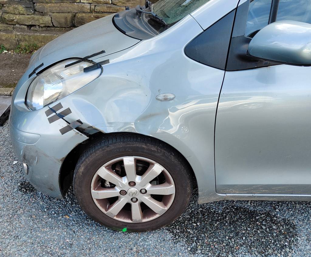

Posts: 8177
Posted : 26/09/2023 2:09 pm
Posts: 8177
After I straightened it out a bit.
@cougar - you're right of course, and we have derailed somewhat insomuch as I only really wanted to know from an insurance POV if we could carry on using the car (if it was otherwise roadworthy)
Posted : 26/09/2023 2:10 pm

 5lab
Posts: 7921
I'd say that wheel looks in a similar position to stock
[img] ?w=600&ssl=1[/img]
it of course might still have some suspension damage. Whilst the wheel may have taken a knock, it also might not have done, if the damage was caused by a 3.5t lorry reversing up, it'd have missed the wheel entirely. I can't see any marks on the wheel or tyre suggesting it had an impact - it just looks like an even covering of grime across all of it
Posted : 26/09/2023 2:18 pm

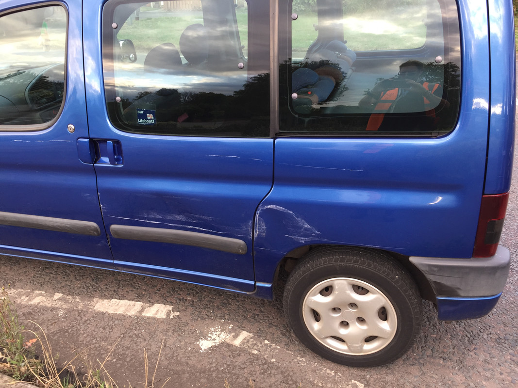

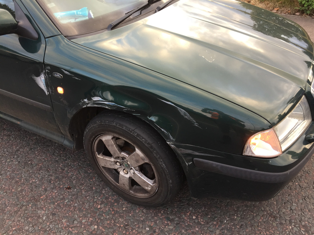

My old Skoda had the wing pushed in, not unlike that. After evaluation by my insurance company’s repair outfit, it was considered economically non-viable, and I was made an offer, and when I asked about keeping the car, they said yes, fine, with 20% knocked off. I had to get it MOT’d again, but otherwise I carried on driving the car for another two years before I gave it away and bought my current car.
some duct tape to cover any possible edges that might catch, job jobbed.
Pretty tidy little car, you could probably keep it going for years, barring mechanicals.
Here’s the damage to mine, done as I was exiting the roundabout behind;
And this is the damage to the vehicle in front of me that was indicating to turn right on the roundabout, then swerved left and squeezed between me and the oncoming traffic, “because I changed my mind”, as she told me, and my insurance company…🫣
Posted : 26/09/2023 10:27 pm
