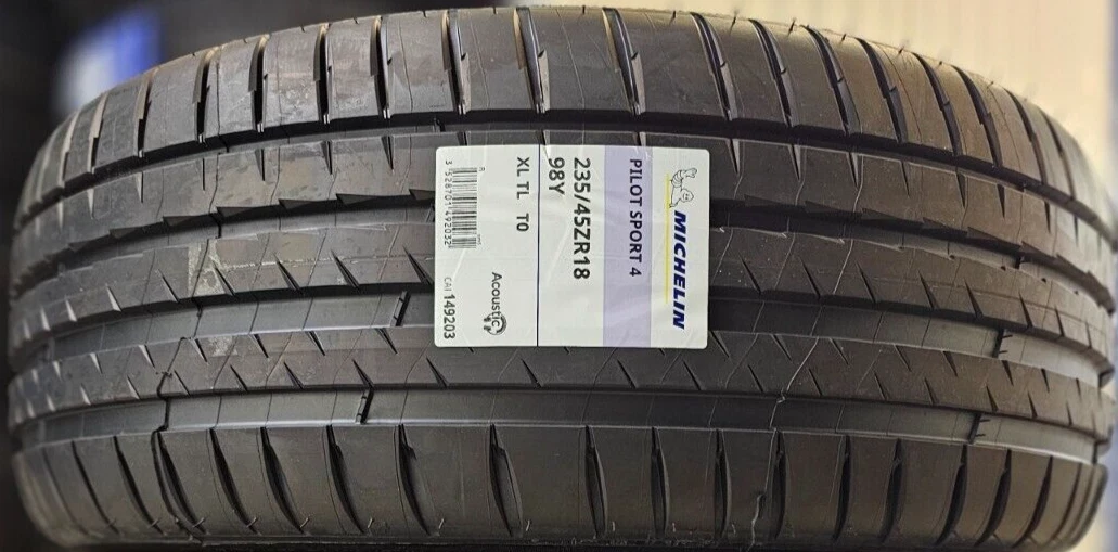

If it were me I'd go to ATS and get 4 Goodyear Vector gen 3- a quality allseason that copes really impressively well with snow and ice, works great in the cold and wet which is imo where tyre performance is most important (because of all dodgy conditions, cold and wet is the one you're most likely to be in, the one you're going to pay less attention in, the one you'll be going faster in and you're more likely to be tired in), pretty good but not amazing in the dry but who cares, and just a wee bit fuel inefficient and noisy compared to a summer tyre.
It's a good tyre and for my 225/45/17 it's £360 for 4 which is not cheap but not expensive. It's passed the "drive on ice without much fuss but then you get out of the car and fall on your arse" test and the "come round a corner and oh **** it's all snow" test superbly for me and does really nothing bad.
Long version...
Main thing for me is that a customer it's just incredibly difficult to really know. Quality brands are an easy guide, even if not necessarily a perfect answer but it makes it much easier, we can instantly hack away probably 2/3ds of all possible choices and even if we lose some good options with them that's still useful. Just like being a maxxis guy or whatever for bikes, every manufacturer has good options but nobody's going to try them all or comprehend all the options. Nobody's going to look up a review for every possible option and even if you did most reviews are bollocks anyway and even good ones may be of limited relevance to you. I have at a guess about 10 brands I'll consider and it's not an informed decision really, it's just a very useful axe to lop off indecision with. I need a good reason to step outside of that 10.
And of course "good" isn't a sliding scale either. What's better, a PS4 or a Kumho Ecsta? It's the PS4, it's better... except why? well the PS4 lasts longer. OK but it's more expensive and you might not even get all the miles out of it, you might puncture or just life expire them. Well sure but the PS4 is grippier too! Yep but you have to drive like a maniac for it to matter. And they both aren't very good in the cold and wet, and suck entirely in the snow. In the end for most people they're going to perform pretty equivalently and the differences might never arise (oh and they both suck on track so it's not like that extra grippiness is ever super useful even at the pointy end. In the end the extra performance is for crime.
Average tyres got really bloody good, a 6/10 low test performer today is probably still a very good tyre. Even right down pretty low, competence is expected. And that 6/10 performer could easily work better for you than a 9/10 test leader, if it's more fit to your purpose. Is your car fast, slow, heavy, do you do dirt roads, snow, lots of night or wet or winter miles, etc etc. Are your tyres a ridiculous size, because on modern cars they very often are.
HOWEVER, modern tyre demands aren't all positive. Everyone wants low noise, good economy, long life, and good grip and that's led just about everyone outside of allseasons to the "slicks in a row" engineering, they all look like this:
And slicks in a row works great until you add snow or mud and then it is disastrously awful. Today's best tyres are worse at that than an adequate tyre 20 years ago, even when new, but the limited crosstread wears out in the first 25% of the tyre's life. You can absolutely go and buy a 10/10, super high quality tyre and then still land in a ditch just exactly the same as on a set of actual ditchfinders.
And even if you could really know what the perfect tyre is, is it even in stock? Is it in one of the eternal churn of discount deals that are pertty much designed to make real pricing incomprehensible?
