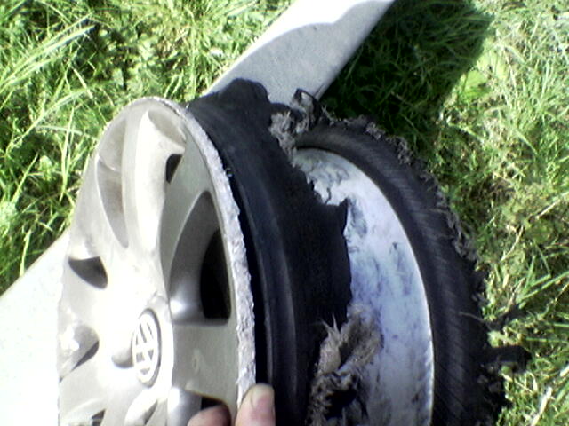

Will she be able to use the repair kit? My sister's new car has a compressor/tyre sealent kit in it, if she does get a flat I reckon she wouldn't have a clue what to do with it. Think spares are on the way out as plenty of people haven't a clue how to change one and would just ring breakdown recovery or a garage. Dunno if this is a good thing or not, replacing a tyre on the motorway is damn scary but dunno if i'd be without one, no repair kit will patch something like this[img] [/img]
