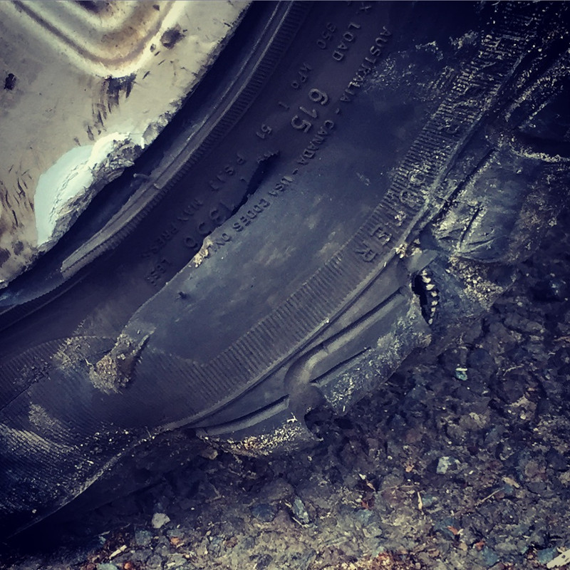

Nearly every time I’ve had a car puncture, it’s been pretty catastrophic. Tyre goop wouldn’t have helped me. If there’s space for a spare wheel, I’d definitely have one.
