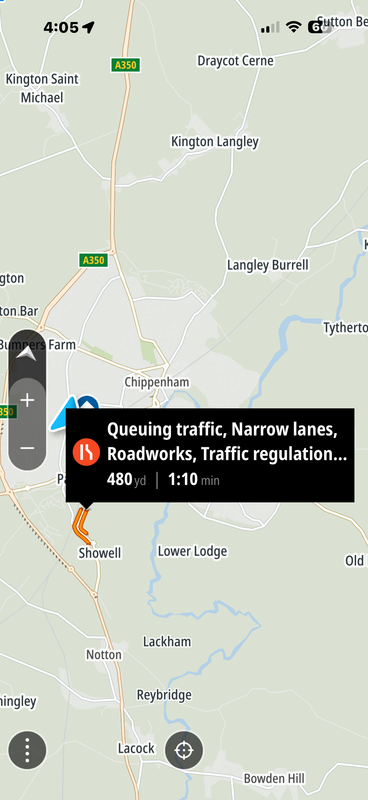

I never use the built-in navigation on my Ford, because it’s almost impossible to update the software; I tried downloading it from Ford’s website, but the files formatting didn’t seem to want to copy across, probably because I was doing it via an iPad, instead of a Windows machine, and my service centre wants to charge £100 for updates because it takes so long on their wifi!
I’ve used TomTom on my phone for years, initially for my job, but I’ve kept up with the subscription because I get updates on a regular basis, and it’s very good at giving me alternative options on the fly, and I get camera notifications as well.
I’ve just taken a screenshot of the current situation around Chippenham, which is pretty much spot on.
The dotted grey lines along the A350 are where there’s ongoing work duelling the stretch from Bumper’s Farm down to Showell, at which point everything slows down due to the road returning to single carriageway most of the way down to Warminster, then all the way down to Pool and Weymouth! 🤪
