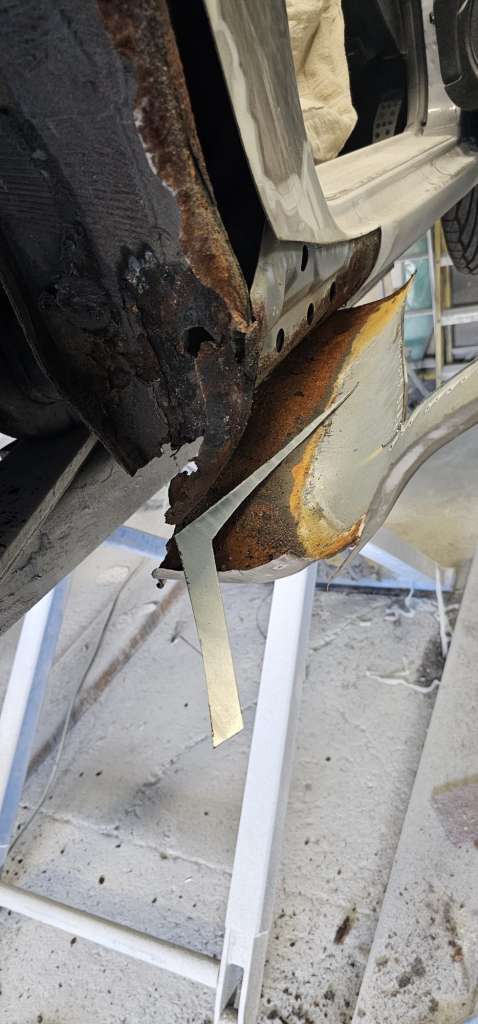

Haha rust. Son is having his MX-5 de-rusted at the moment. He knew it needed doing when he bought it. I knew they were bad but I didn't realise how bad!

Haha rust. Son is having his MX-5 de-rusted at the moment. He knew it needed doing when he bought it. I knew they were bad but I didn’t realise how bad!
What do you mean bad? That's pretty much factory fit on an mx5
