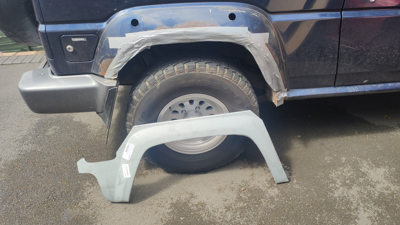

Just had a similar decision. This was on a Fourtrak I bought, knowing the wheel arch was bad and price adjusted by £400 to reflect this.
Removed the plastic wheel arch cover to expose a couple of small holes and a ling of bubbly paint. A quick clean up with the wire brush on the angle grinder exposed the extent a little better.
It was then £60 for the patch panel and £250 to get it welded and waxoiled.
I would have welded it myself but a friend who is a much better welder than me offered which I was glad about as their was an awkward hole inside the wheel arch which he did at the same time. Apparently the whole job took over 10 hours, the arch was tacked and then stitched in place in a couple of hours but then it was all of the 'fiddly bits' as he put it.

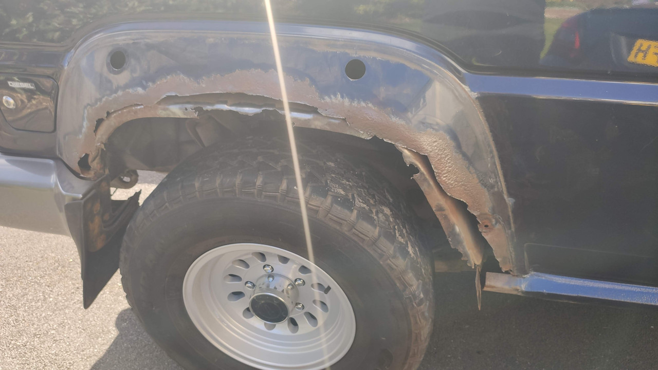

The photo of my truck shows what happens when you clean back some bubbles of rust. Also you can see where I painted the cleaned back bit with Aqua Steel rust converter to leave weldable metal.
