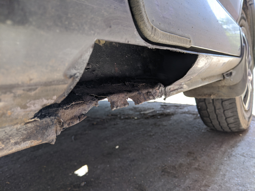

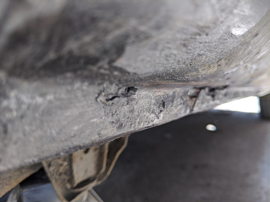

It's like this see. I've started to tackle the terrible bits of rot on my Toyota Hiace. I've mostly done the bad patches on the tailgate and am now working on a few spots on the sills.
All of the worst rust seems to be on the drivers side. The van is originally from Grimsby and it's my theory that the owner parked on the seafront with the drivers side out for years...maybe.
Anyway, bits of the sills are fairly bad so I have a bit to cut out and weld back. The photo with the big hole, I'm not sure what I've got to actually weld to 😳

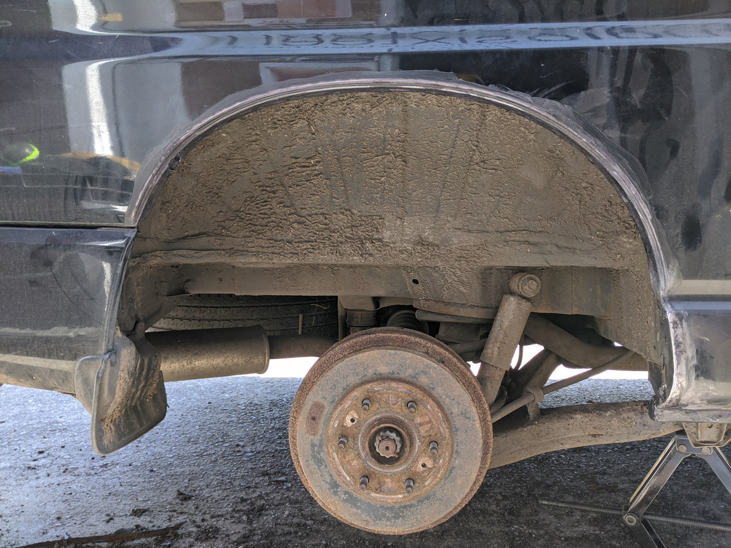

My plan is to extend the border of underseal paint upwards a little after I've done all the welding. I also think I might do a small border of it coming out of the wheel arch on the outer body surround.
My question really, apart from any general tips you fancy dropping is do you normally prime the bare metal with......primer, before you wang on the underseal paint?
Particularly around the wheel arch where a smoother appearance is wanted.
The tin (Hammerite underbody seal) says nowt about that but obviously it's normally just under the car. If I'm bringing it up the bodywork, would you prime or owt?

Don't use that underbody seal! It's horrible! And shite! I used it many moons ago and regret it every time I go near the car.
Yes, you need to prime. Personally I'm a fan of POR15. That and black stonechip over the top and you're sorted.

One of my main gripes is the fact it never actually sets. Not like stonechip where it's slightly rubbery and to a certain extent self healing, more like just having wet tar on the car. Every time I work on it I get the crap all over me, and I did it nearly 10 years ago!

your gonna have to cut that inner sill back to something goodto weld to for a start.
underseals horrid stuff , stone chip if you must , i use the tetrosyl stuff in wheel arches etc.
, youll be fighting the rust every other year to the end at various parts of the body work IIRC youve already done the door steps ?
