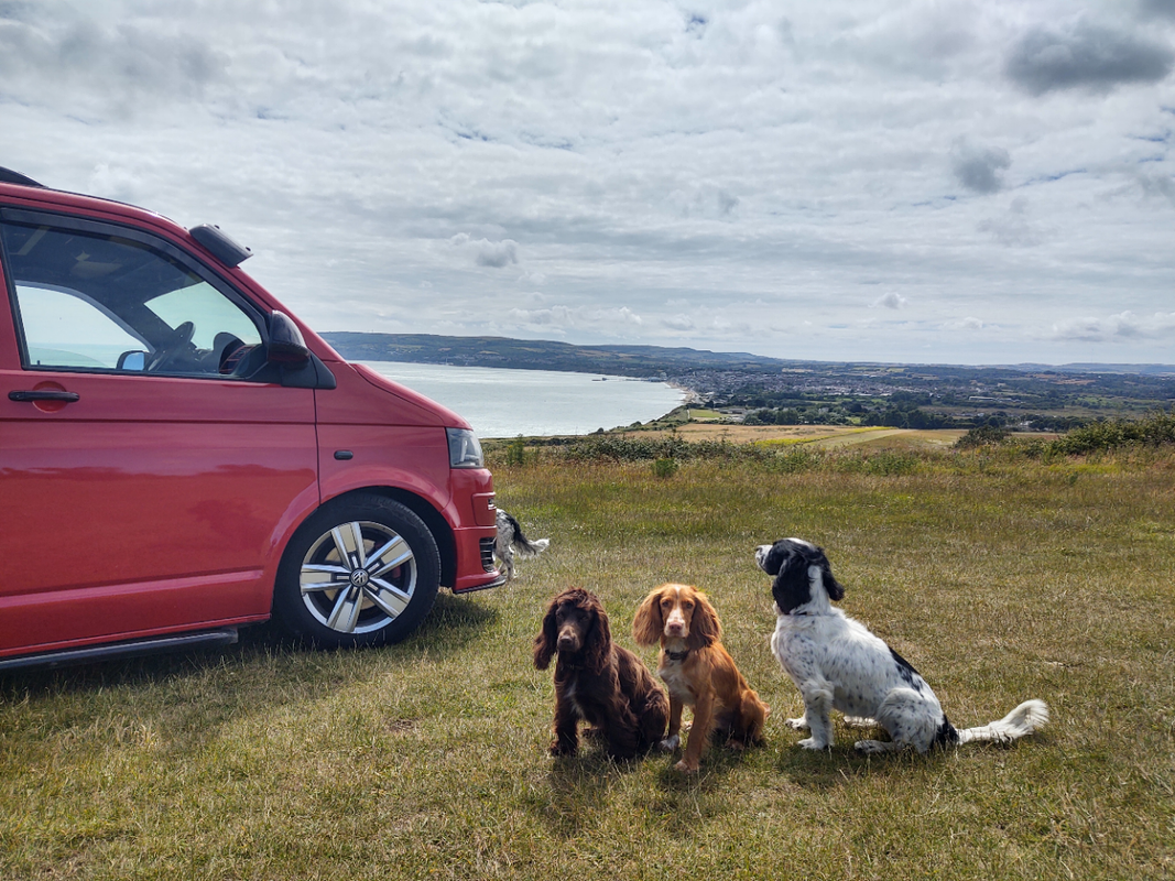

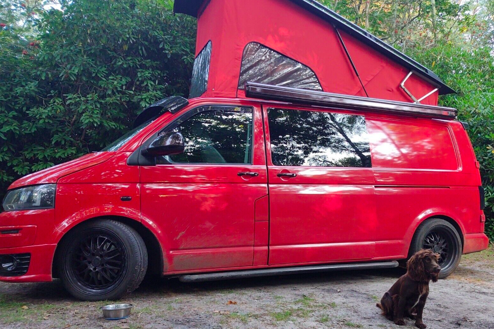

Smaller wheels with taller sidewalls certianly help with ride comfort, but in my experience, the extra weight overwhelms the standard dampers and causes a certain amount of "shake n' shimy" on certain road (or off road) surfaces.
here's my T32 LWB 4motion on it's "let's orrfff road" rubber:
[img] https://pbs.twimg.com/media/FQOTM8lXIAIroEm?format=jpg&name=large [/img]
[img] https://pbs.twimg.com/media/FS0DGTFXsAE4x7y?format=jpg&name=large [/img]
245/65/R17 BF's TO2's on Twin Monotube Projekt AT's, no rubbing on std springs / ride height, not too much noisier on the road (a little bit, but a T6 is not exactly a quiet van anyway) but the fuel economy has taken a dive. Lovely off road (esp with the 4motion + diff lock) and, imo, looks the dogs (lol)
The tall tough sidewall and small wheel certainly never gives me cause to worry on either unmade roads or tall kerbs. Primary ride is better than on the original sport line 18's, although theres a bit more lean in the bends (not too bad, and againa T6 isn't any kind of sports car) but secondary ride is certainly worse over high frequency corrigations etc. Plan is to move to a better damper package to control the additional tyre mass (they are VERY heavy!) and idealy to height adjustable air springs to get a lower on-road height, a taller off road height, and the ability to self level when parked up on sloped terrain

Liking the maxtorque look! Current tyres are vancontacts - suspension - unsure, think original bar being lowered a little?
