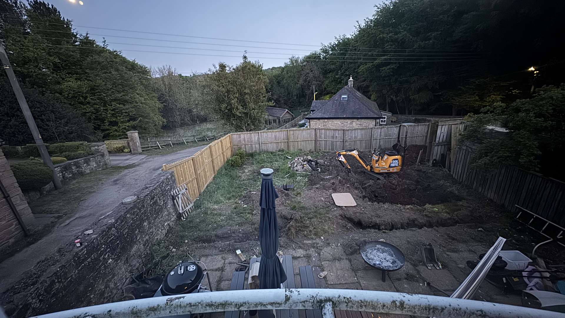

Hi, so following on from my exciting concrete and gabion posts..
Our garden is about 160 square metres (minus garage and a pond), is on a slope and varies by about 18 - 22” side to side.
Due to access only via a bridle way I need to level it without adding any soil.
I’ve asked for 3 professional quotes:
1. Chap number 1 - 1.5hrs later than agreed. Told me he doesn’t need the work (so why come?!)
2. Chap number 2 - 1.5hrs later than agreed. Refused to give a price for the job, instead kept quoting an increasing day rate. When asked for a ball park figure he stomped off.
3. Facebook guy - very low quote (£300) for a long days work. Was happy to quote without seeing the garden!
So, I’m left wondering - what would be a reasonable quote / amount of time required?
Could I do a reasonable job myself with a hired mini digger?
From poking about with a spade, it seems we have about 18” of half decent soil and my thought was to dig down 18” on the left hand side of the garden (so there’s a little bank and then level from there?
Thoughts appreciated!

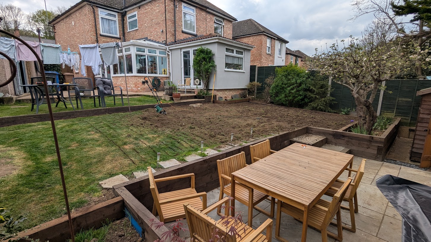

I've recently levelled a smaller sloping garden (approx 60m2), mostly by hand.
  • Dug over turf by hand
  • Used an electric tiller/rotavator to churn it all up
  • Raked it all level (using a combination of rotavator, rake, scaffold board)
  • Compacted it down (gardeners shuffle)
  • Added some pre-turf fertiliser
  • Laid turf
Before doing the above I've also spent a lot of time adding retaining walls and edging to give clear boundaries.
But just for the levelling, the cost was about 280 for the turf, about a tenner for the fertiliser and I bought the tiller from ebay for about 35 quid.
Obvs there's no hourly rate in that, but I'd estimate that added together it took me (an amateur) about 3 days.
Whether 1k is worth it, I guess is up to how much you value your time versus having someone do it for you.  If you're talking 3 times the area I worked on, then having someone else doing the grunt work def sounds appealing 😀
Posted : 03/06/2025 9:17 am

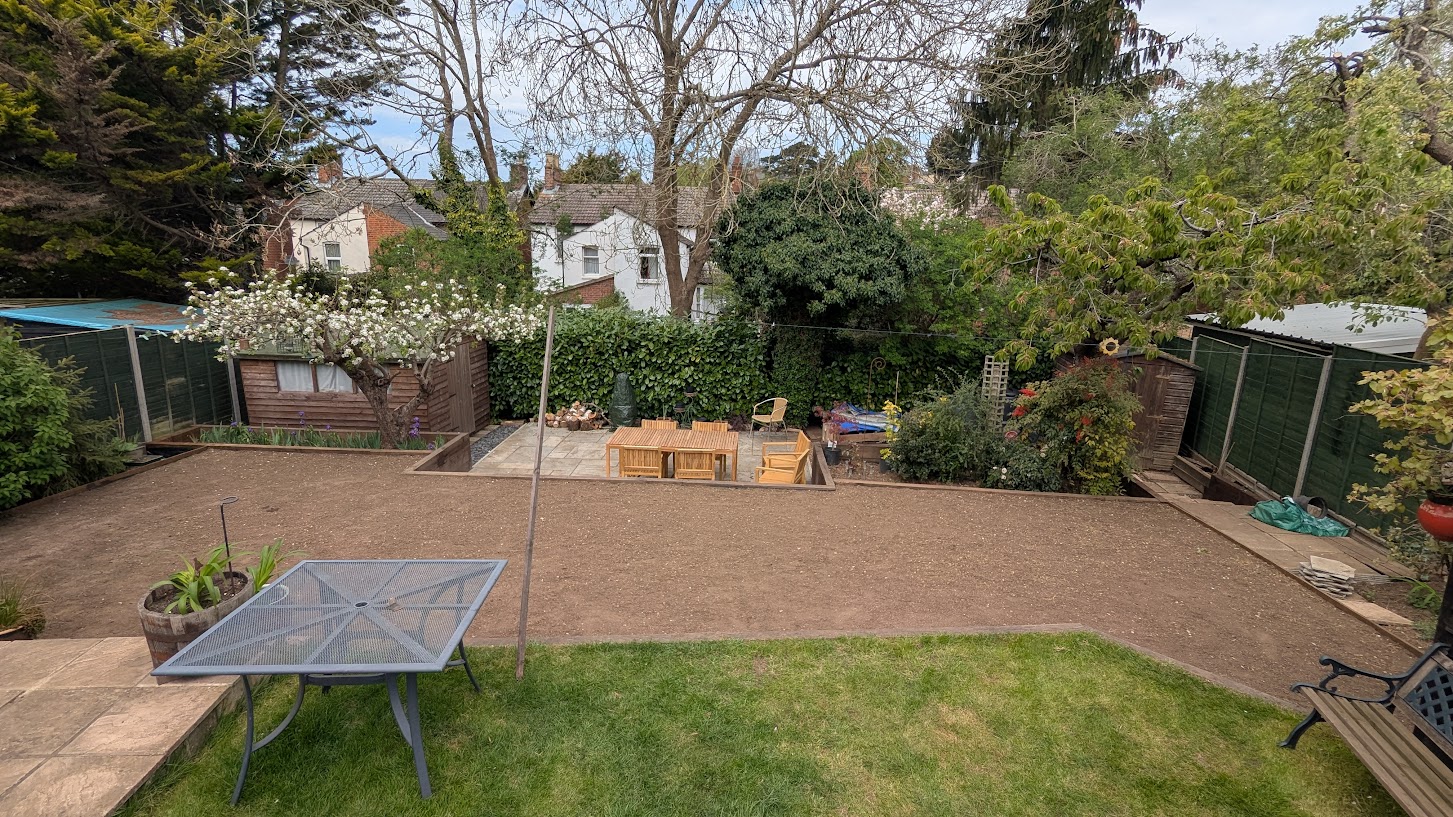

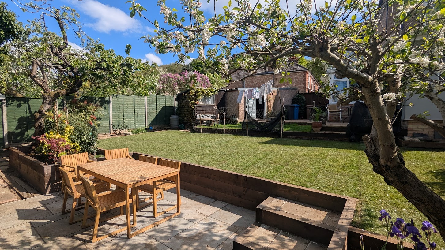

Posts: 3427
Work in progress
Waiting for turf
Tadaaa
Posted : 03/06/2025 9:22 am

There’s a retaining wall (and my new amazing gabions) on the far side, with a 4’ drop into the next semi’s garden.
