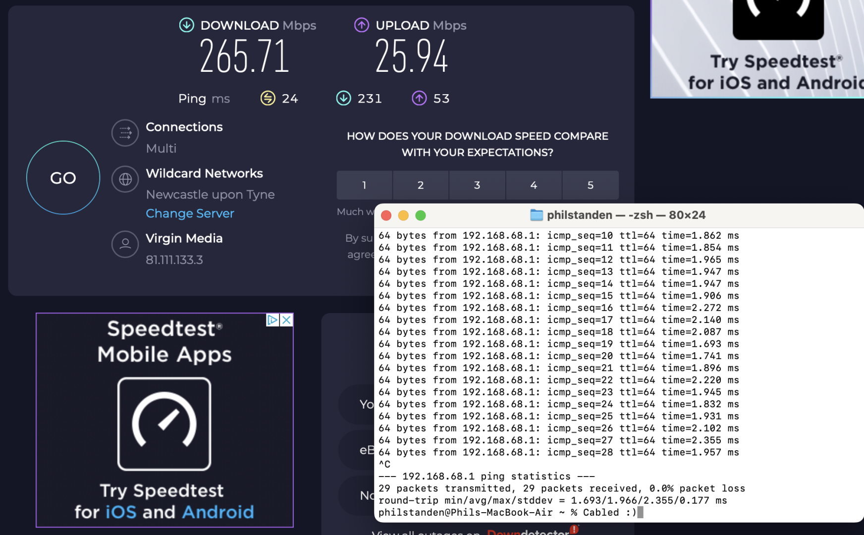

Sorted.
Plugged my laptop in to the suspect Deco unit with it running un-cabled and got speeds of 260ish.
Plugged the cable in between the Deco and another known good one and speeds dropped to 80ish.
Re-made the plug on one end of the cable between them, plugged it back in and now have speeds with it connected via a cable of 260+.
So looks like it was a dodgy cable. Cheers all.
I'll keep an eye on it over the next few days to make sure Deco doesn't kick things off the unit I'd expect them to be connected to like it had been.
Posted : 12/05/2025 5:57 pm

Posts: 4324
No idea of my actual LAN speeds? Don't know how to test that.
Posted : 12/05/2025 6:00 pm
Posts: 15068
Posted by: phil5556
If thats speedtest.net or similar, then that's your connection speed including your LAN speed...
If you log into your router you can see your houses actual connection speed to the outside world.
So say thats 80mbps for arguments sake...
If you then do a speed test in a web browser on a PC or from a mobile phone connected to the router, etc, and it's only 70mbps, you know you are loosing speed on the connection between the router and the connected PC/phone/tablet/whatever.
Which is kinda expected on wi-fi rather than cabled.
For example..my PC is connected to my router via wi-fi, and sees 75.1mbps on average which is kind of expected.
Posted : 12/05/2025 6:26 pm
Posts: 4324
Posted by: mattyfez
Yes it’s from Speedtest.net
I get about 260Mbps when I run it which matches my Virgin 250Mbps service.
But my LAN network should be quicker, presumably up to 1000Mbps. Not that I ever really do anything over it really, apart from backup my laptop to a drive attached to my desktop.
Posted : 13/05/2025 12:22 am
