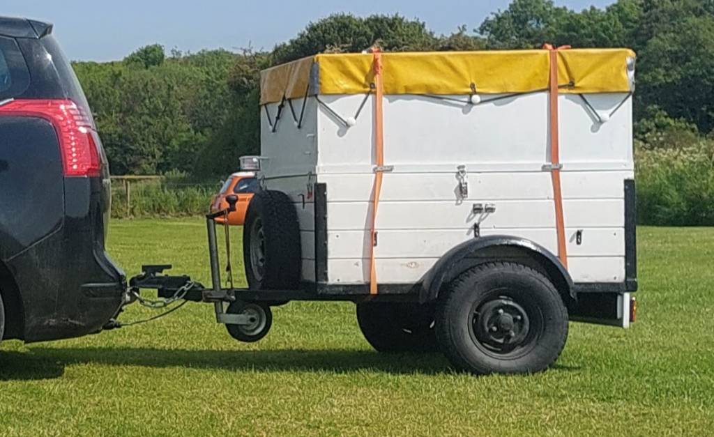

Don't make the mistake I have. I bought a used one from a retiring market trader for £60. Spent about £30 tidying it up, new light board etc. But it was quite shallow and didn't hold everything. So I made a height extension for it. Now it holds plenty, weights about 300kg when full. But, I can't reach in to the bottom of it to get everything out! So I have to either use my special stick with a hook screwed in to the end, or take the whole extension off and then put it back on once empty. I need to change one of the side panels to hinge down, but it'll never by high enough priority on the to-do list so I'll just keep camping kit fishing for now.

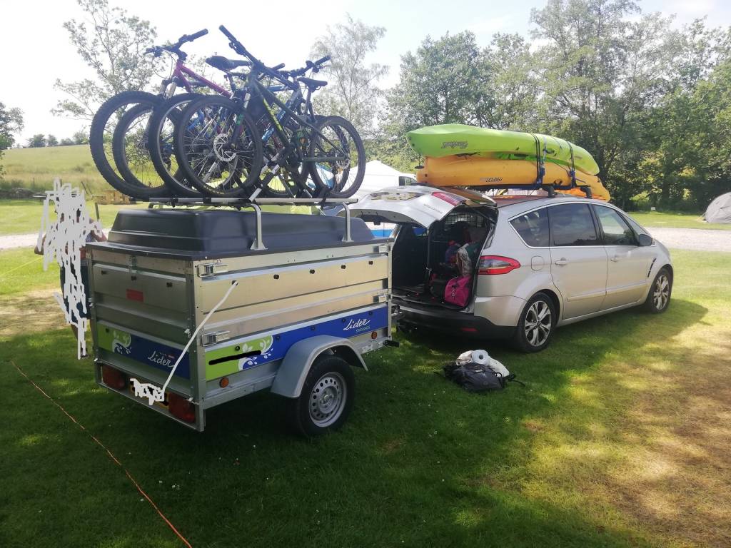

<p style="padding-left: 40px;">I have a Lider Saragos with side extensions, ABS lid and roof rack. It's a beast. We have a large dog who hogs half the boot and a very large 8 berth air tent so the extra depth is handy.</p>
The best bit of trailer wisdom I can offer if you are new to towing is bigger trailers generally go forwards and backwards better. I've got two trailers that are at least a metre longer to the axle and both are easier to reverse than the one pictured, which is just the right side of "not too annoying".
The other thing I would say is find an empty car park or friend's field and practice reversing with it for a while. There's some good content on you tube.
Usually it's quicker on a campsite to unhitch and swing it into place by hand but if there aren't too many ghouls about try and have a bit of a reverse every time. Every once in a while you'll have to back it into a passing place or to turn round when you've taken a wrong turn and every little bit of practice helps.
