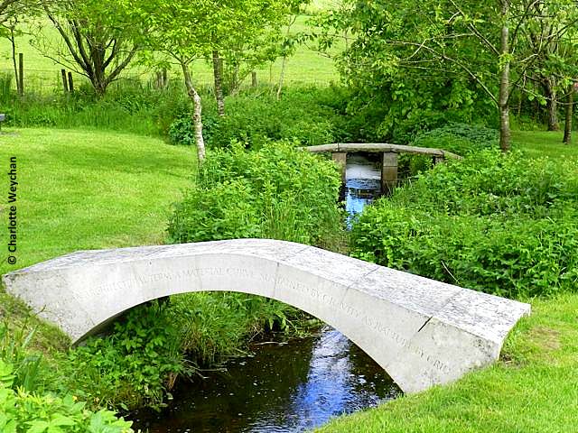

<span style="color: #444444; background-color: #eeeeee;">I know keeping it straight will be more functional, but curves would make the bridge look so much better!</span>
An arch is only behaving like an arch if its in compression - cutting an arch shape out of something isn't achieving that.
You'd be better off spanning the distance with suitable, straight un-cut timbers and clad the sides that with something you like the shape of. Perhaps add a nice little inscription like the one below 🙂
<span style="color: #545454; font-family: arial, sans-serif; font-size: small;">“</span><span style="color: #6a6a6a; font-family: arial, sans-serif;">Arch</span><span style="color: #545454; font-family: arial, sans-serif; font-size: small;">, n. an architectural term. A material curve sustained by gravity as rapture by </span><span style="color: #6a6a6a; font-family: arial, sans-serif;">grief"</span>
