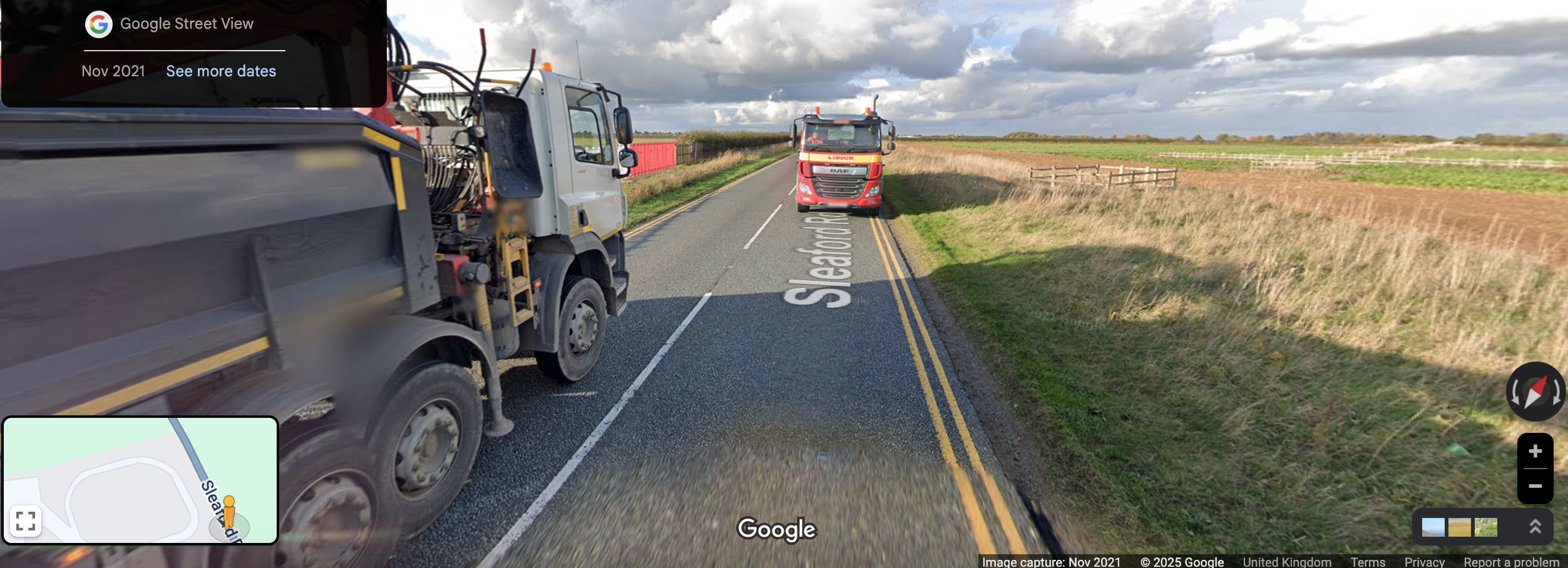

2mile journey? Surely bicycle is the correct answer?
oh if only.  commute is on a dangerous road, grass verge, no cycle lane, lorries hurtling past.  ive been forbidden from biking it by my family.
Failing thatANDyou can charge it away from the road/pavement then an EV is the answer. Even the cheapest most knackered Nissan Leaf on autotrader will do 10x that journey on a single charge.
without crossing threads with the EV one, wouldnt i need to pay lots of pennies to get a charger installed?
But as above - bike, or ebike, is the solution for 2 miles. I wouldn't even bother, I'd be walking.
you really wouldnt want to 🙂
