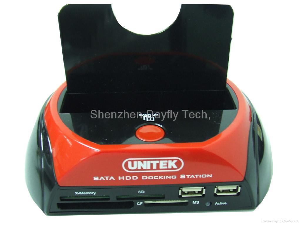

I like eSATA/USB 2.0 HDD docking stations, like this:[img] [/img]
Posted : 04/07/2011 12:32 pm
You can get dual disk models, and then just choose whichever SATA HDDs are a good price per GB at the moment.
