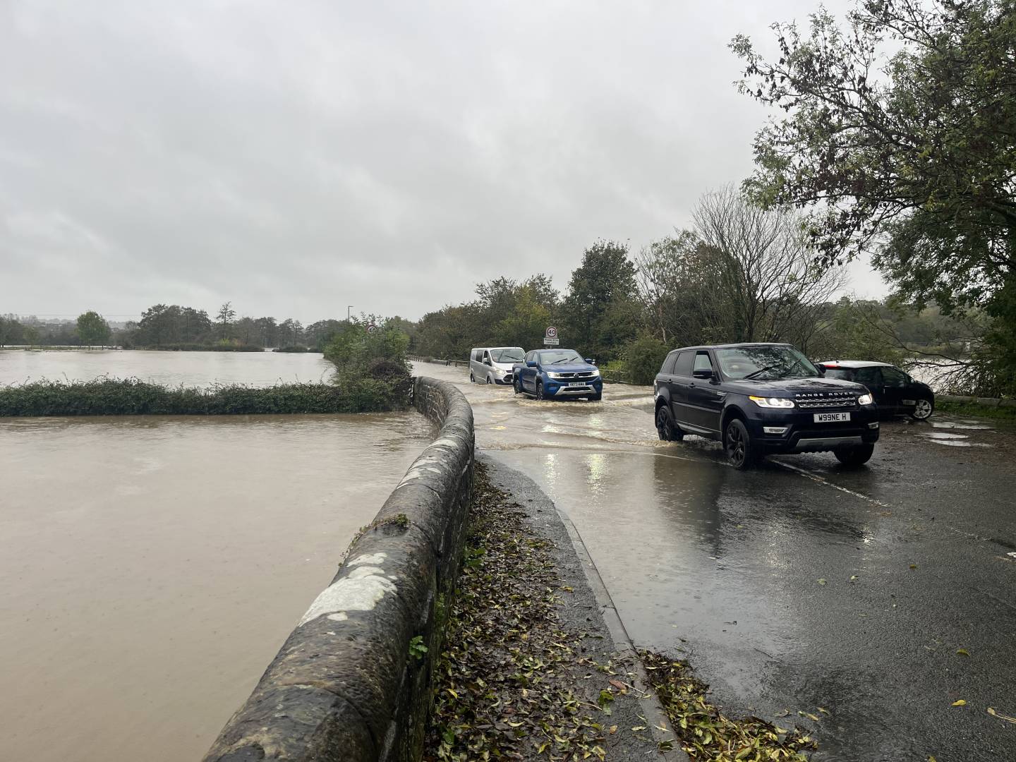

Posts: 13388
It really can be very localised. The pic below is just round the corner from me - it floods like this a couple of times a year. We are certainly less than 100m from this, but crucially the road rises gently and we sit about 10m above this. The pic below that is our flood risk rating.
Re @zippykona - I'd not be buying in that location as a retirement home. You don't need that sort of stress as you grow old.
