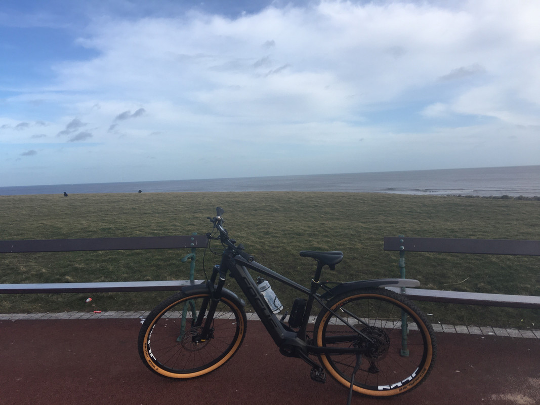

Not only that I managed to get out today for the first time in two weeks and had a lovely ride out to the coast. Marvellous. 😎
