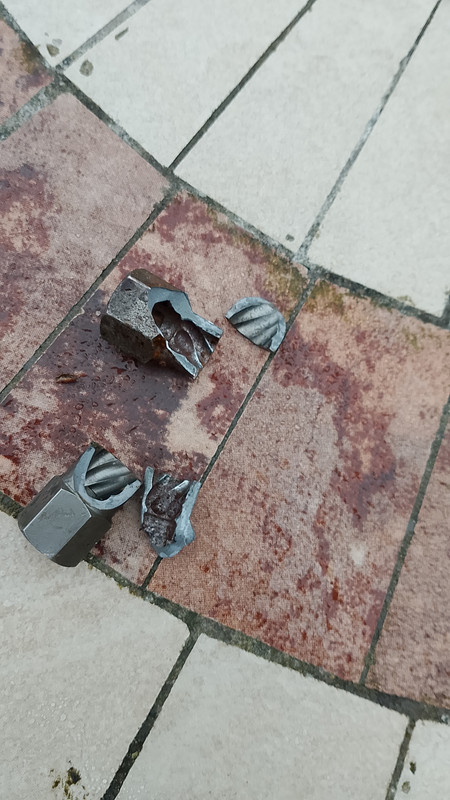

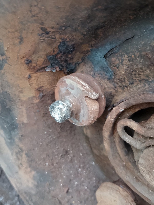

Moving from the crusty steels back to the summer alloys and the stock twin profile wheel nuts on the front drivers wheel were tight as buggery - which is odd as I torqued all 4 wheel to the same 110nm in November.
Anyway got three off eventually. But the locking wheel nut profile sheared.
All the locking anti theft gubbins are off so it's in essence a stud looking out. About 20mm long 10mm dia
I've run of out hi pen and maap gas I've broken/shattered two Irwin bolt grips,it laughed at the ugga dugga..... The ugga dugga just broke the bolt I had welded to it off in the end ....
Next move might be cut it off at the neck and grind down to the taper see if I can't get the wheel off to release the tension and hope it comes off then.
Any other options the hive mind has?
Photos later.

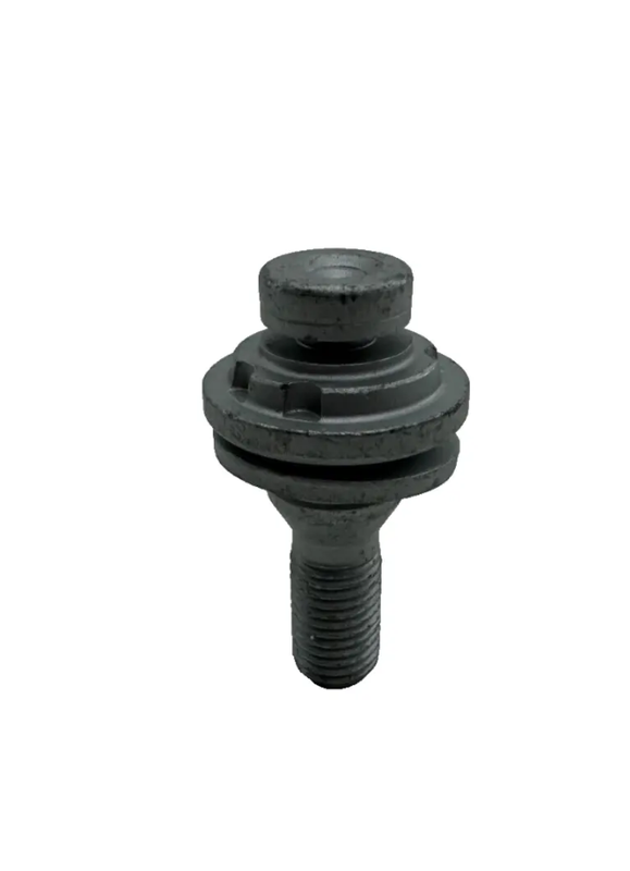

It's this style. To be replaced with non locking nuts.... In this modern age who steals factory alloys off a Peugeot. - 406 steelies are probably more desirable in the scene crowd

I'd try welding an oversize nut over the bit of stud that's sticking out and then use a very long breaker bar rather than an ugga dugga. Make sure to get a good pool of weld inside the nut.

Angle grind flats on it, or even a proper hex if you are gifted with an angle grinder.
If it still resists, oxy- acetylene to heat and hammer it from the sides before trying again.
Still failed, grind it flat and drill through. After being heated to beyond colours it should be soft enough to drill. You need to be very accurate with a drill. Start small, say 6mm and work up.
When you finally get the wheel off bin it if you needed heat.

Angle grinder plus stilson wrench.
Make the nut into a rectangle shape by nipping down two opposite sides.
Then use some large stilsons on it

The stud.is recessed in a dish on the wheel and close to the angle . Can't get my 12 or my 48" stillsons in any useful position on the stud. Which is a shame. Very little resists the 48"
Posted : 26/05/2024 8:43 pm
Very little resists the 48″
I've seen stuff try but that definitely will, available area is too small for the jaw unless you weld some scaffold pole around it or have a BMX peg handy.
Left-field thought, do you have an SDS? If so get it on chisel mode and massage the end, it'll either help shock it or just put a nice stipple on your wheel. Might help to do that once you have a nut on that can keep the tip in place.

Welded on a big nut . Applied lots of heat and plusgas.
Got plenty torque into it..... Sheared the bolt behind the nut .
New drill bits ordered. -yay
**** knows how it's got this stuck . Weird all 4 bolts on this single wheel needed major break out.

Well it's off
Waited for the replacement wheel nuts as destruction was assured.
Drilled through the centre.
Drilled with the biggest drill I could and countersunk it.
Still couldn't break what was left even with a 6ft pry bar through the wheel spokes.
Ground the taper off the wheel so wheels fit for the bin. It then fell off.
Remains turned out of the hub by hand.
So it has absolutely been over torqued but of course no one has been to a commercial garage with it.....
Snapped spring replaced , new shocks , new track rod ends and new lower ball joints , new wishbone bushes and new anti roll bar links - both sides and the tracking done  Like a shiny new car (underneath)
Now to find a new(to me) set of steel 15s for my winter tires to be moved onto.

Some very unexciting pictures. And yes it's rusty. It's 10 years old in the north east of Scotland. Not 3 years old in the south west of England.
