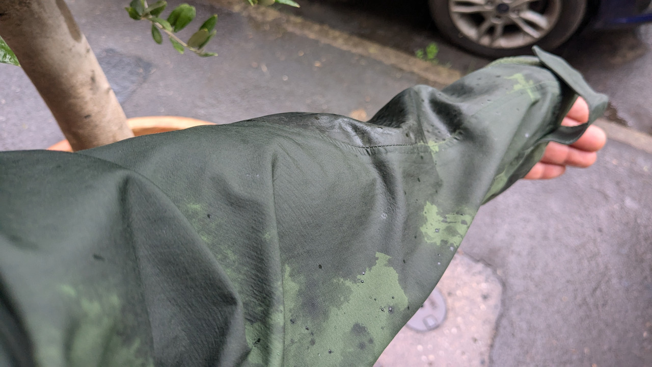

Anyway, just gone outside in the glorious July rain for the first time since reproofing, and the jacket has wetted out within a couple of minutes.
Pretty much no beading as you'd expect.
Really not impressed. ?

I use graingers with better results than that but not as good as new.  I put the garments on radiators to get some heat into them.  I think without heat it takes a lot longer for the repellent to become effective
did you clean your washing machine well before washing it in?  I run boiling water down the dispenser and put it on a long hot wash

Thats goon to affect the results quite significantly.
Waterproofs sould go nowhere near the washing machine until it's been de-detergented fully. Whether that's a general wash or pre reproofing

I think it's the same thing but just in a bottle instead of a pouch, but I've used this recently on a 20+ year old Berghaus jacket and got good results with beading afterwards. I ran an empty cycle on 90 degress (on whatever the fastest program was that allowed it) to clean out the washing machine and then follwed the instructions with about 30 mins in the dryer on low heat afterwards and then hung up to finish drying. I think the heat part is pretty critical. If you don't have a dryer then it says you can use an iron. I guess a good blast all over with a hair dryer would also work.

thats your issue then.  The stuff I bought clearly tells you to do this.  Like Scotroutes I prefer to do it by hand and I also do it twice - once4 with washer / reproofer and once with just reproofer.

You need to get the machine really, really, really clean before using it. Residue from fabric softener and enzyme-based detergent will kill Goretex and similar material in a single wash. I've learnt that painful lesson myself.
