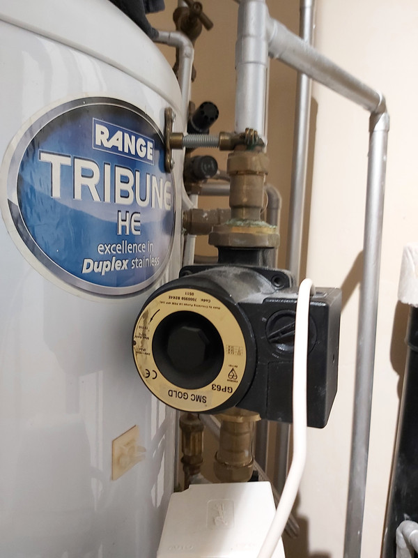

Just found this thread as our boiler is giving me the willies. It's not dead yet but our radiators never fully heat up and the tap water isn't as hot as it was.
We live in a street of 12 year old houses and loads of people have already replaced their boiler. I'd rather not have to do it in an emergency, in the middle of January, with a screaming baby under one arm.
4 story house with a big water tank on the second floor, boiler on the ground floor. Constant steam blasting outside so does that mean none condensing?
No idea where to start choosing a replacement.
EDIT: update- tap water is now freezing, showers are freezing. Radiators are only warm at the top. I've switched on the immersion heat on the tank. Xmas money is about to go down the drain.
Posted : 28/11/2021 12:01 pm
It’s not dead yet but our radiators never fully heat up and the tap water isn’t as hot as it was.
Might just be the pump or a solenoid valve is on the way out, rather than needing a new boiler...
We get through a CH pump every few years, must be on our 4th or 5th now (same boiler). Often giving it a whack with a screwdriver will get it spinning again when it's on the way out, so buys a few more days before it refuses to turn at all.
Posted : 28/11/2021 2:35 pm
Insulation upgrades are not needed in a lot of ASHP installs, however that is with current RHI funding, it will be different when the new scheme comes up although think the vouchers will be snapped up very quickly
Do you mean the insulation upgrades are not needed to get the funding or not needed to keep the house warm in winter?
Genuine Q as we're in a drafty, solid walled Victorian house with voids under the floors etc, so we leak heat all over the place.
Posted : 28/11/2021 2:37 pm
That's not a boiler fault. The system's full of shit silt, needs flushing.
Posted : 28/11/2021 3:29 pm
Might just be the pump or a solenoid valve is on the way out, rather than needing a new boiler…
That’s not a boiler fault. The system’s full of shit silt, needs flushing.

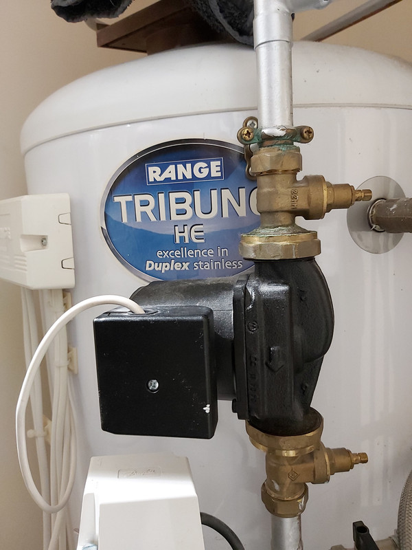

You might be right. The boiler sounds like it's firing up and working as normal. The pump sounds like it's doing something but when you move the power switch between levels 1,2 and 3 it cuts in and out and takes a while to come back.
It fitting a new pump a DIY job? It's just sitting right there, easy access.
I've bled all the radiators but where do you start draining the system? Is there a big filter or sump somewhere?
We've got heat and water now with the immersion heater but it'll be costing a small fortune to run.
Posted : 28/11/2021 4:03 pm
It fitting a new pump a DIY job? It’s just sitting right there, easy access.
Yep, very basic plumbing, you just needs a large adjustable spanner and some towels. You don't even need to drain the system as the pump should be installed with shut off valves immediately above and below it. NB You will have to wire the new pump in, but that is also very simple.
I’ve bled all the radiators but where do you start draining the system? Is there a big filter or sump somewhere?
If there is silt in the system it will be sat in the bottom of the radiators, so draining the system won't shift it. Most modern systems have a magnetic filter installed which slowly attracts the muck and you then clean it out every so often (every few years in our case). I added one to our 30+ year old system a few years back.
The problem you have sounds like the pump isn't working properly, not circulating enough hot water to get the rads properly hot; or, less likely, a solenoid valve is only part opening (they normally just fail and don't open at all).
Posted : 28/11/2021 4:16 pm
Thanks for the tips as always chaps! I feel almost optimistic.
Considering the price of pumps and the fact it's probably never been touched or replaced I don't mind fitting a new one. With any luck we'll get some hot radiators on the top floor for the first time.
I just need to find a replacement for this...
I have Screwfix and Tool Station 5 minutes away. This could be sorted tomorrow if I pull my finger out.

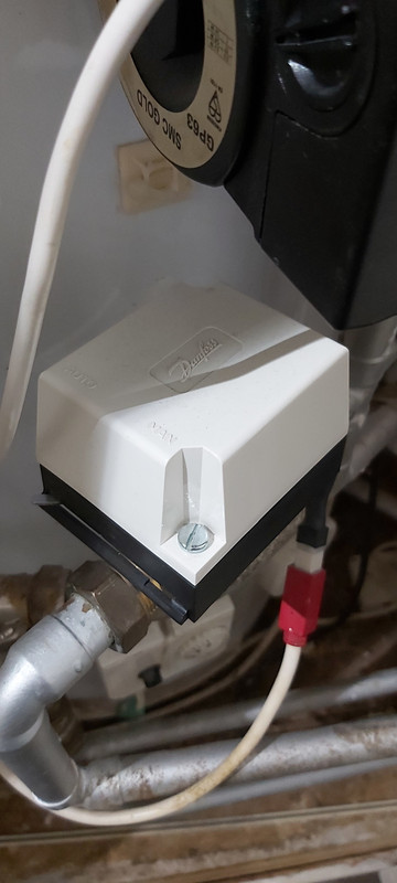

Could be the 3 way diverting valve shark attack. Cpuld be gummed up rads if bled thoroughly and still cold spots.
Drain off valve is a swaged 15mm jobbie with a square 8mm top, usual outside or on a low rad near the boiler.if the boiler fires up ok then it cpuld be tje pump, or its full of crap
Can you drain some ch fluid intp a jam jar and add some wire wool or steel nails. Use the bleed off on the top of a rad. If they rust then you jave been running the system with insufficient inhibitors. So you need a power flush and magnetic trap fitted. Might not be too expensive maybe £250 or less if your not dpwn south
Posted : 28/11/2021 4:45 pm
Posts: 7167
Yep, tjat looks straightforward enough.
Adj spanner on the valves top and bottom, if you don't have the handles. old towel and big adjustable on the pump flanges.
Maybe crack the front nut to depressorise the pump first.
Pick up sentinel x100 when your there as well.

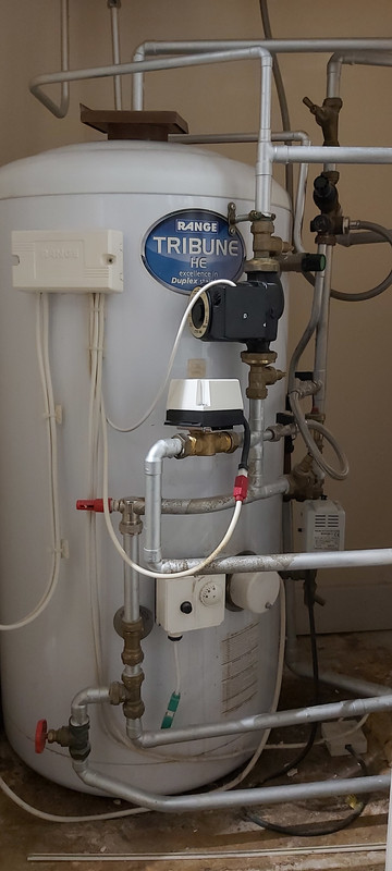

That munsen ring mount looks a little worrying, i guess its an aesthetic cover amd not a water tight jacket

So your 3kw elec immersion heats the water tank and then the idirect ch fluid rund through that and heats up? which then evenly heats the rads ? abit slowly but it does something ?
stuck diverter valve usually has a go -no go feedback wire if its not moved into the correct postion , but you boiler stills fires which does sound like pump but ianap. Bear is , he knows more than me , i just sell the bits and bobs
I saw that and thought WTF!
Posted : 29/11/2021 8:16 am
Posts: 13916
If the tank construction is anything like my Megaflo's then the outer shell is just there to hold the insulation around the inner pressure vessel (water tank)

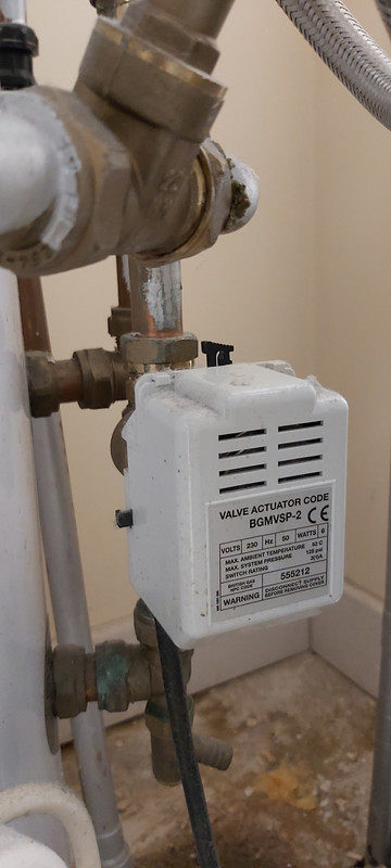

Our turn now, woke up to no HW!
The HW motorised valve motor has died, lukcily the manual over-ride is fine, so just delayed showers (currently waiting for it to heat up).
Must be the 3rd or 4th motor I've replaced since buying the place. Funny thing is the CH one is original to me, so over 20 years old. Although, thinking about it, for most of the year it doesn't do anything, whereas the HW motor comes on every day.
Posted : 30/11/2021 8:42 am
We also woke up to no hot water since we switched the immersion heater off yesterday morning. Radiators are still working though. I've started contacting plumbers, I want it sorting out rather than guessing.

Thanks to all the tips I've tracked our problem down to this thing...
When I tried it the other day and when the Mrs checked it today the lever was just flapping around. Tonight when the timer is on and the radiators are roasting but we had no hot water I turned it to manual, felt the resistance and could hear it opening up. Five minutes later, hot tap water. But also full blast heating regardless of where I set the thermostat. So it's all or nothing at the minute.
So not fixed yet but very relieved to know the source of the problem.
Posted : 30/11/2021 6:54 pm
OK, when the motor has turned the valve on, the lever goes loose like this. This is normal.
When the motor is off the lever has to overcome a spring to open the valve and normally makes a winding noise as you push it across.
Five minutes later, hot tap water. But also full blast heating regardless of where I set the thermostat. So it’s all or nothing at the minute.

This is what we have. I freely admit I have no idea how it all works...
This is the little lever that wasn't doing anything but I imagine it wasn't 'activated' when I first checked. Last night when we had toasty radiators but no hot water, I pushed it from Auto to Man and heard something kick in.
The gave us hot water but also I think I realised that our radiators are on separate circuits. The ones in the rooms have the adjustable valves on and go on and off with the timer no problem. The radiators in the passage and stairwell don't have the adjustable valve they're just one or off. These are the ones that were blazing last night after I moved that switch. I didn't even know our house could get that hot. I had to switch off the boiler itself to cool it down.
Is this another valve which unleashes something else?
Unfortunately, I've had to come to work again and leave Mrs and baby at home with no hot water and we still can't get a response from any plumbers.

The motorised valve in the bottom picture looks like the one that heats your hot water tank (as it's in that circuit). That's the one you want to manually open to see if that fixes your hot water issue - if it does then it's that valve that's at fault (also check that it's getting power when the hot water is supposed to be being heated).
The valve in your first picture looks like it controls the central heating (but I can't see where the pipe coming out if it is heading). By pushing it to manual you overrode the thermostat so the boiler just kept going and the rads without TRVs kept putting out heat - the ones with TRVs shut down because they'd reached the room temp hat they're set for.
So move that valve back to manual [do this anyway/now] and manually open the lower valve.
I also see what looks like a water thermostat on the cylinder - check what temp thats set for. That could also be a failure point - if it's broken it might stop the valve opening for the hot water.
Oh and I'd be checking the control box with a meter also as a bad connection in there would stop power to a motorised valve or the hot water thermostat.
The main thing is that your boiler is absolutely fine, you just need to find out what's stopping water going from the boiler to the HW tank.
So there's a few things to check but they're not difficult - but move that CH valve back to Auto first.

The trvs will lower the flow rates or shut off the rads where they are fitted. Your hall ones on open loop just fun on f s a. Turn down the stat if they are red hot.
Looking at your photos looks like 1 pump, 2 x solenoid valves plus filling loop, drain valve, 2 or 3 prv for safety.
Dumb q is this gas of just electricity. I can see the tail of the immersion in the piccy but no gas train.
The boiler works if the rads get hot throughout which is great. What you have is a control issue.
Hot water from the boiler goes up stairs to a coil inside a cylinder and back again via the pump.
Hot ch fluid goes round the rads pushed by the same pump.
To allow hot water to be produced without heating the house a valve lets the hot ch fluid go up to the hw tank via a valve and the pump.
In winter another valve opens and lets hot ch fluid circulate round the rads in a out and back loop. This is controlled by the lower lhs valve i think.
It will be the highest rhs valve that lets ch fluid recirc through the hw cylinder, indirect heating system. Hopefully its just this thats stuck shut or broken. Iirc the tops come off and you can manually operate them, or slide lever operates the valve.
These are not expensive and ypu can switch the motorised valve yourself
Why?
If you look in the picture it's the lower motorised valve that's in the HW heating circuit and the upper one doesn't seem to be related to the HW circuit as all.
Could be wrong obvs.
Posted : 01/12/2021 10:43 am
Posts: 7167
I think you correct. A closer look reveals the ch drain down point under the solenoid, however that could also enable drainage of the indirect loop.
From that pic its impossible to tell
We pretty much typed the same thing
Easy way to tell. Hold pipe up stream of valve. The one that doesn't burn your hand is busted
Posted : 01/12/2021 10:55 am
Posts: 13916
It looks like the pipe coming out of the [bottom of] the lower motorised valve goes straight into the tank - in which case that valve is controlling the HW.
The one that doesn’t burn your hand is busted
As I said, the valve might be fine, the issue might be power getting to it or the HW thermostat saying that the water hot when it's not (i.e. it's bust!).
The first thing to discover is whether the valve will open manually and if this fixes the issue. If it does then why isn't it opening automatically? - either the valve is bust or there's an 'electrical' issue (which could just be a connection)

I managed to get a reply from an actual plumber today. He asked what the problem was, I sent him the pictures and he said he'd get back to me with a price and a date. This was at 1pm and I've heard nothing since.
The Danfoss thing is back on auto. I can't see how to switch the bottom one to manual. It's not obvious and I haven't crawled into the cupboard for a look. I might have a look when mini me is finished screaming himself to sleep. My head is pretty battered by this time on an evening now.
