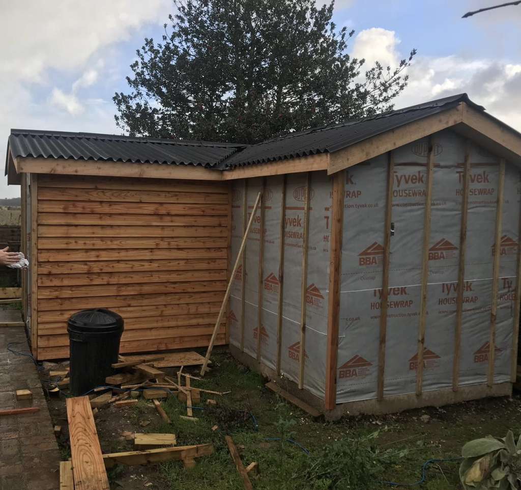

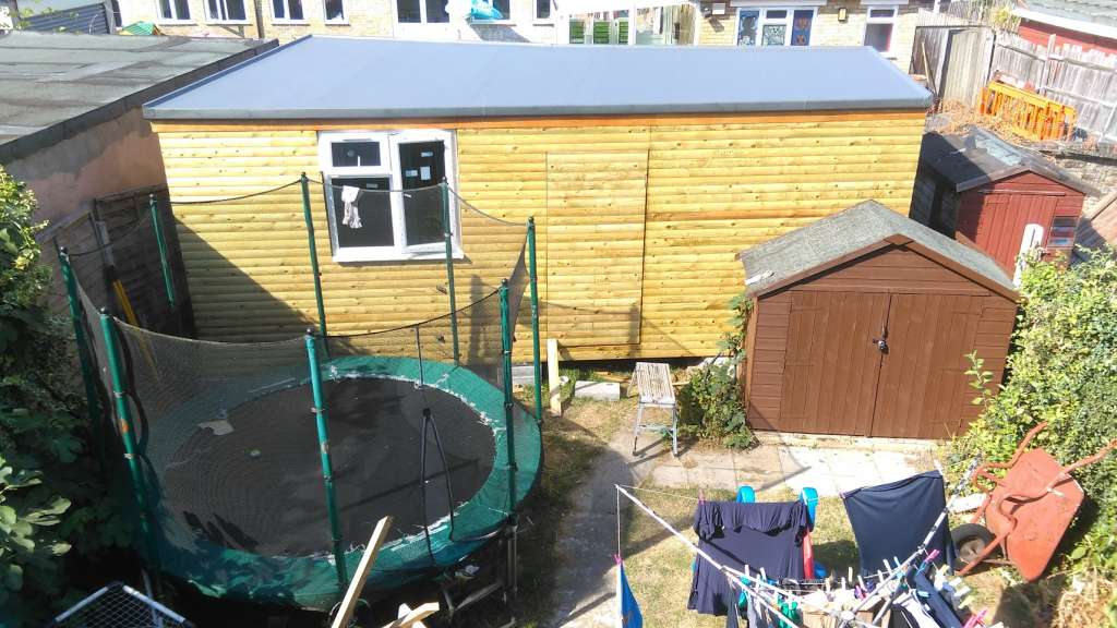

Gladly,
86d54e45-420f-4d8c-949f-9a00135f316b
Part clad at that point.
Concrete base - local landscaping firm
Timber and other materials - delivered by builders merchant
Larch cladding - local sawmill
Double glazed windows - double glazing direct or some such.
Cost me about 3k in 2019. Built in a hurry before my daughter was born.
Posted : 06/11/2023 11:44 am

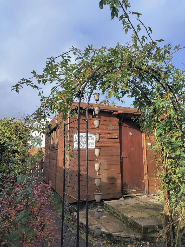

IMG_20231106_113554
14*10ft. Possibly over built. Built with my dad who never took chances with a build. Poured concrete base. Frame of 4*2s. Inside lined with osb board screwed to joists. The idea being if anyone tried to break in by removing the cladding they wouldn't get past the osb. Windows are small and high enough to be hard to climb through. Frosted glass. The door faces the house and is light at night
Roof is steel sheeting. In retrospect I would have given it more of a fall than it has.
The height was chosen to match adjacent garage and do avoid being too in your face with neighbours.  If there were no issues I would go with plenty height for overhead storage.
The bottom of the cladding overhangs the base and is a few inches above. 20 years on no issues with rot apart from one window cill that needed replaced.
Edit - the water damage to the veneer at the bottom of the door was from before I fitted the canopy to catch any rain when the wind was from that direction.  Worth having something over the top of your door to catch water.
Edit 2. If I was doing it again I wojld make the door a bit wider. It's fine for bikes and everday use but now and then it's awkard moving big objects like some garden furniture in.
Posted : 06/11/2023 11:47 am

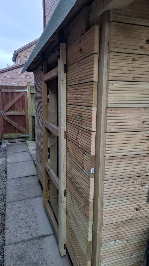

IMG_20231105_155001
I'm making a replacement shed out of fence posts, decking, OSB and substantial timber for the framing. It needed to be narrower than the previous shed, moveable and cheap. So far I'm between £400 & £500 for the build. It'll only store gardening stuff but will have potential to be recycled into something else like planters in the distant future if needed. The overhangs are doing a good job of protecting the decking + I've room for expansion at either end if more space is needed. Base inside is made up of euro pallets which can be removed if I need to shift the shed for gable access in the house. Sliding door for space saving as well.

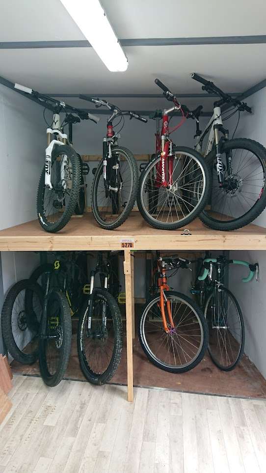

 irc
Posts: 5188
@alanl
I like the double height bike storage. May needto see if my garage is high enough to do that and have a reorganisation.

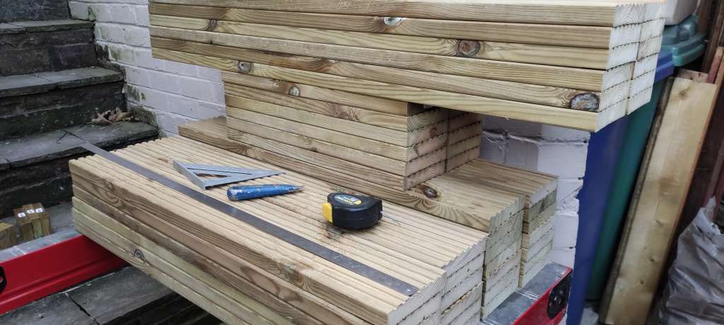

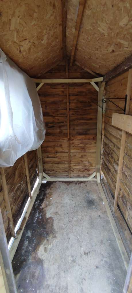

IMG_20230917_113536IMG_20231017_163410
Inside the old shed. Held together by additional frame I added a few years ago.
Decking boards cut up to minimise offcuts. Taken a few weeks so far.

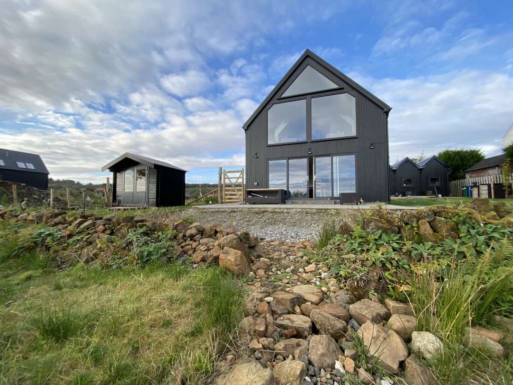

IMG_0738<br />The little one on the left - a 3m x 2.5m log cabin from Tuin - we regularly get 50mph+ winds so your average shiplap shed would be splinters after one winter. Built on a concrete ‘ring’ foundation, 300mm wide x 300mm deep and then about a dozen steel angle brackets and 6” concrete screws to hold it to the foundations. Corrugated metal roof, to match the house. I have a bench on one side and static bike on the other - I can just sit there pedalling with the doors open and enjoy the view:
IMG_2793
