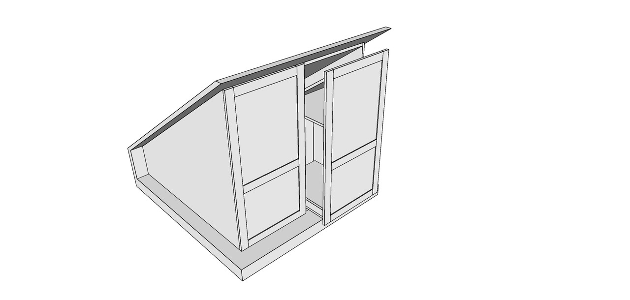

It's actually not a bad idea. I've seen this sort of thing in posh kitchens, making use of tall thin spaces. You'd probably have to be really careful not to overload it though, a wardrobe full of jeans and jackets is likely a lot heavier than a couple of jars of Hellman's.
Maybe you could have a sort of hybrid solution, a drawer recessed back into that 40mm drop and a wardrobe on top?

Posted : 06/06/2022 4:23 pm
 DrP
Posts: 12041
^^ that IS a good idea....

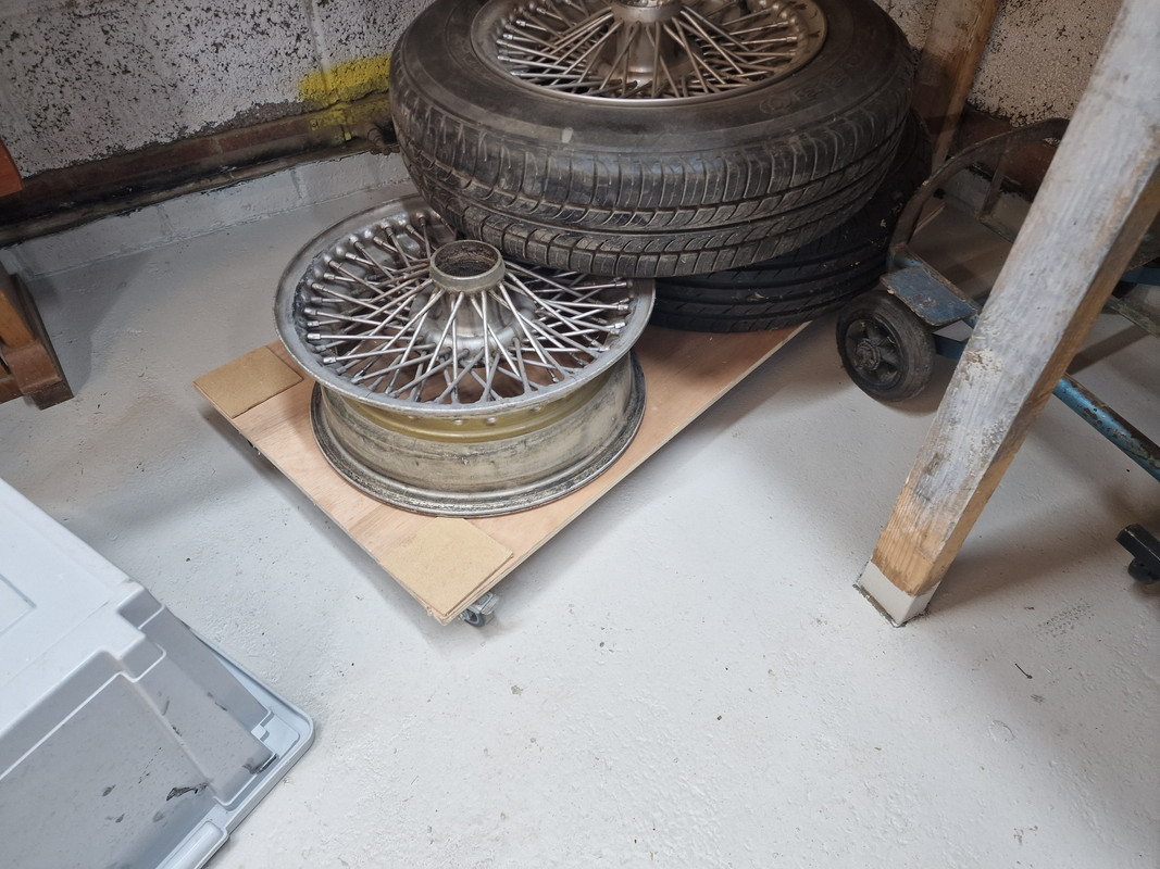

Just build a small box on wheels with a sloping top to fit the gap. You can then roll it in and out of the gap and have a useful storage box for all the crap that doesn't go in the wardrobe - shoes etc

Just build a small box on wheels with a sloping top to fit the gap. You can then roll it in and out of the gap and have a useful storage box for all the crap that doesn’t go in the wardrobe – shoes etc
That's a really great idea.
Bloody annoying nice birch ply is now about £130 per sheet... but yeah, you're basically suggesting a huge one of these...

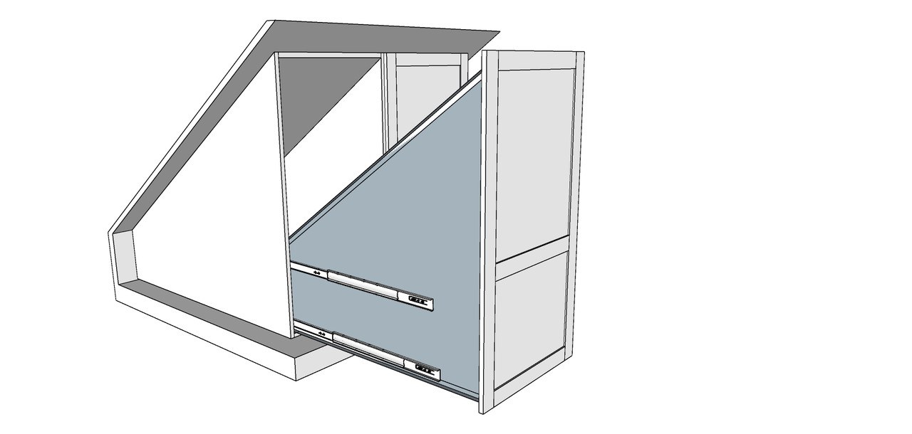

Maybe a bit like this?
There's simpler ways but with some big runners you could maximise the space.

@kayak23 . that's the sort of thing i was thinking about with strong runners... How would yo do it?? Frame it out first, then make the drawers from sheeting/laminated MDF?

that’s the sort of thing i was thinking about with strong runners… How would yo do it?? Frame it out first, then make the drawers from sheeting/laminated MDF?
It's much easier to keep everything square and consistent if you build boxes.
Most fitted furniture these days is based on simple boxes that fit into the space with a little room around them.
Drawers etc are then mounted into these.
It's way less faff than battening out a space etc. Arguably you might lose a tiny bit more room but it's much easier and neater in general.
I guess it's more of a 'do it for a living' way of doing things as it minimises time on site, as you just waltz in, level up the box you've made in the workshop into the space, fix it in position and fit trims all round to take up wobbly walls, then fit your internals in.
Much easier.
For your own home you could do it the other way. Personally I'd pretty much always go to the box within the space approach as everything is easier and looks neat.
So yeah, I'd make a box that's a bit smaller than the space, then make your slide out system to fit it, then fit the whole shebang into the space making sure it's level and square, then fitting trims around it to walls and floor.
It looks like quite a big unit is all so it has to be well built and on some serious runners to work well as a pull out unit.
I'd use 18mm sheet material throughout.
Smaller drawers etc I'd generally use 12mm but you'd need a pull out unit that size to be really rigid, so 18mm and heavyweight runners.
Posted : 07/06/2022 3:19 pm

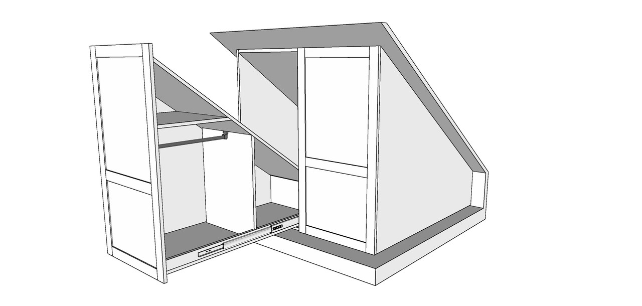

Posts: 13369
I was suggesting something like this but with 4 sides tacked on.
You could go all fancy pants like Mr "I am a carpenter" Kayak if you wanted something to look a bit nicer I suppose 🙂

Have a pair of angled hanging rails with pins/stops/loops on it (like some clothes shops) mounted to the ceiling, either with a gap in the middle to access the clothes, or back to back and accessed from either side.
Tall stuff at the front, short stuff at the back.
Probably all sorts of stuff you could use as rail, 21mm uni-strut slotted channel, tensioned chain, just saw you can pay £60 for an angled hanging rail with a spring stretched over it to hold your hangers too.
Obviously you'd need to check the hangers will hook on and off nicely without jamming them under the ceiling!
You could also put a low rail across the back and hang those box organiser things that are designed for t-shirts and shoes...and they will hide entrance to the secret room 🙂
Posted : 09/06/2022 4:50 am
Posts: 1406
“Remember that it’s unlikely that kids will need a full height hanging rail, so turning it sideways and lowering it gives you some more options.”
Tru dat…
I guess the key decider is “how low a hanging height can i get away with?”
the lower the height, the further back i can have the hanging space..
So the net says “106cm…” for hanging, but i reckon 60cm would suffice for kids stuff
Yeah but kids have this habit of growing taller and needing bigger clothes. So unless you want to be doing all this again a few years (which will go by faster than you think) I'd aim it at adult size clothes.
I fitted a new rail in a built in wardrobe for my 12yr old at the weekend. Measured the height by getting one of my suit jackets (as the longest thing I have hanging up) and using that. No idea how high it actually measures though.
