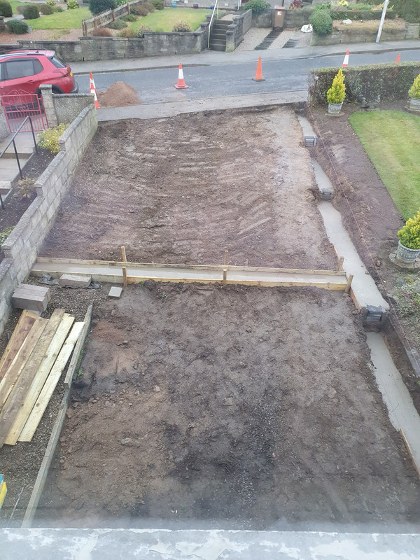

We had this done about 18 months ago. We had 8 drop kerb stones, they had to remove a couple of tree stumps and dig out about two lorry loads of earth. They fitted edging stones to make a small border, a foundation layer and then grids topped with chard flint. Was £4.5K.
The block paving was already laid:
Posted : 24/11/2020 12:03 pm
