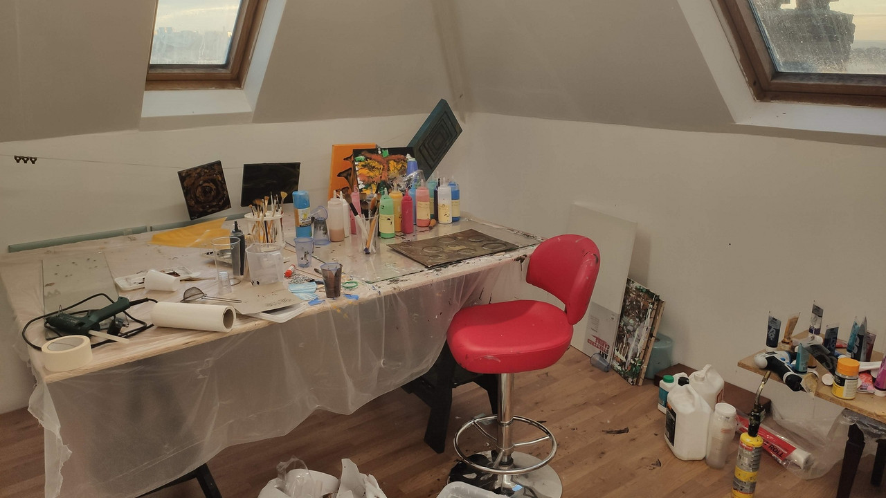

This is the IKEA desk top I referred to above:
https://www.ikea.com/gb/en/p/gerton-table-top-beech-50106773/
It’s solid beech and decent value compared to the solid worktop options. It does have some metal strengthening rods/strips underneath to stop it sagging (I presume cos it’s not as thick as a worktop).
It’s a nice size at 155x75cm, but bigger than normal and as it’s solid too you could adapt it a bit more for your needs. I wanted to round off the edges but my wife likes it at 90 degree (there is a little chamfer on it).
We have 2 IKEA plain white legs (£2.50 each!!!!) which are nice and solid and a matching drawer unit at the other end - the drawers are really nice despite being a bit of a faff to construct.
I’ll try and get a pic later.
EDIT:
Sorry it does look a bit small in this pic as my wife has all her painting stuff and a canvas on it but it’s big for a normal desk.
Underneath
I can refinish it at any time and make it reasonably waterproof (she needs it due to paint/water she uses).
Posted : 14/01/2021 9:05 am

Posts: 7561
Built.
Posted : 15/01/2021 8:50 am
Built.
Posted 19 minutes ago
I wouldn’t have that in my workshop never mind an office!!! 😉😉😂😂

Posts: 13369
[i]Built.
I have better than that in my studio 🙂

Posts: 7561
It's got history!
https://hebtro.co/2020/04/07/the-door-is-still-open-you-just-cant-come-in-for-now/
