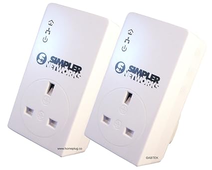

Looking to get wi-fi/internet to my shed at minimum cost and have a pair of BT vision powerline adapters that I found when we moved.
The house has had a full rewire so all cables are new, including the cable to the shed.
I'm not too good with this sort of stuff but was wondering if I can use the 2 adapters I have to get wi-fi to my shed approx 20m from the house.
The ones I have are these:
Power
If so, how do I do it?
Any tips gratefully received.
Posted : 06/08/2019 9:53 am
So long as everything is run off the same consumer unit you should be fine. I live in an old house and there's a couple of corners that the wifi can't reach and the power-line adaptors work just fine.
Plug one of the adaptors into a socket close to your router. Run an ethernet cable from the router to the adaptor. In your shed, plug in the adaptor to a suitable socket. Finally run an ethernet cable from that adaptor to your computer or if you want wifi then you'll need another wifi hub and run the cable to that.
Posted : 06/08/2019 9:59 am
I do what whitstone suggests, but my 'extender' has wifi as well at the garage end. I've since disabled the wifi, as I upgraded to BT Mesh, but a computer and CCTV box still run off the ethernet powerline adapters. They work perfectly quick enough.
