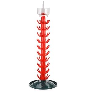

another bit of kit which is really good is the Fastrack system. Its not perfect for 500ml bottles, but i find them really handy for bottling day.
[url= http://thefastrack.ca/main/homebrewer ]Fastrack bottle holders[/url]
Something like that would be pretty handy. Is that better than a bottle tree?

Hi zilog,
the 23l syphon is designated like that because of the length of it i.e. its long enough to get to the bottom of a standard FV. the 4.5l syphone is much smaller and used for demijohns I think. For your needs a 23l syphon would be needed. Som might say they are overkill but its just one less thing to worry about on bottling day.
As for the fastrack i think its really handy, although i haven't used a bottling tree. As i say you can't get 20 x 500ml bottles in one rack because of the diameter of them, so you have to stagger them across the holes, but i have got enough bottles (c.40) on 3 racks without too many issues. if you have the space these are really stable and easy to use i.e. rinse / sanitise your bottles, rack them here to dry off, get the rest of your bottling gear ready and then pluck them from here when you are ready to bottle. The bottling tree wins if you are really tight for space, but i dont know how stable they are.

I'd also add get a bottling tree if you are going to bottle in any quantity (10gal brew lengths and above) saves me no end of time, and the foam from the starsan stays in the rinser.
