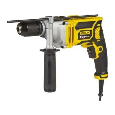

3″ soffit vent hole saw in pine timber.. Drill caught using holesaw and whipped out my hand at 300rpm
Drills that have a 2nd handle on them are good to own.
Ive a number of cordless drills, but when needing something with a large bit, or where theres the possibility of it catching i use my percussion drill. Stanley fatmax. the front handle make a big difference.
Other uses are with a wire brush or wire disc wheel, where it wants to kick off the job, the handle gives far more control.
2660840
The right tool for the right job 😉
Posted : 26/01/2024 11:55 am
Posts: 467
I've got a similar looking drill labelled Dewalt. The 2nd handle on mine is as shown...but it clamps around plastic...last time I drilled a large dia. hole in a wall with it I ended up with a similar injury to Footflaps caused by the 2nd handle slipping down on to the chuck when  the holesaw jammed.....My 15 year old son coming out with a well meaning 'ca va papa?' got a slightly less polite response I'm ashamed to say.
