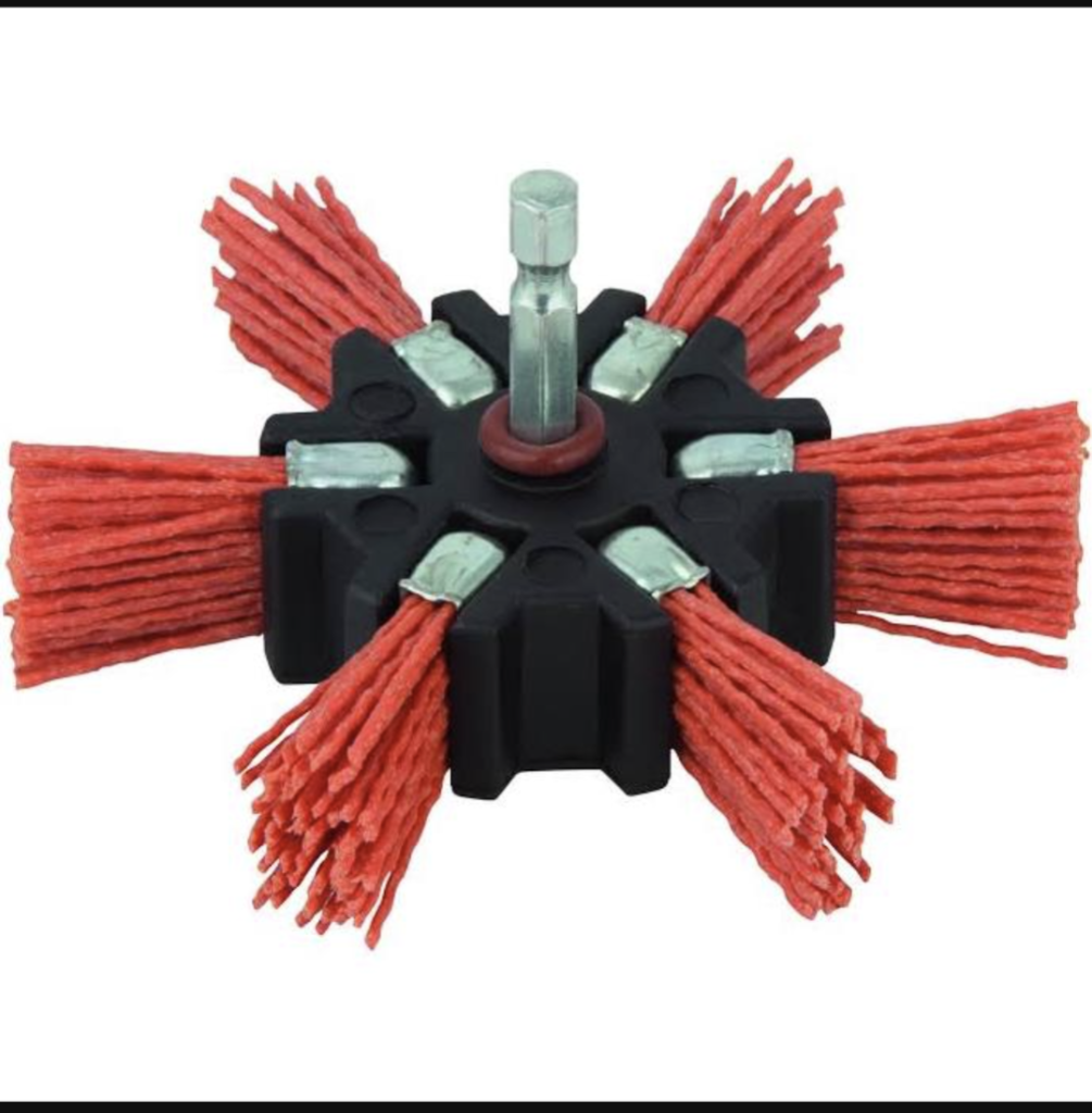

I'm a fan of these ones. Bit less aggressive than wire and you don't tend to the up with a million metal splinters in your face and arms.
Toolstation have them
Posted : 26/06/2023 5:44 pm
Ooh seen those but never used one, how well do they last?
(I'm derusting an MX5, which is a bit like saying "dewooding a plank", so always on the lookout for shortcuts)
Posted : 26/06/2023 6:30 pm
I don't really know on metal unfortunately as I've not needed to use them for extended periods. You can get different grits.
I've mainly used them when scorching wood, where once burnt, you 'brush ' the grain out with one of them.
