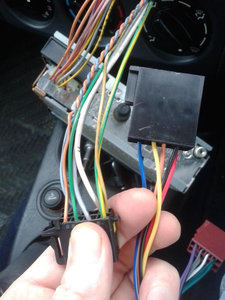

Right got the right cable, however the iso connectors seem to be wired up a bit differently, anyone know what should be going where?
The iso to head unit wires have what they are written on each individual wire but the loom to iso ones don't.
[img] ~original[/img]

Figured it out, blue to blue, and orange accessory and red switch cables inverted, now works as should, hopefully I haven't borked something and the battery'll be flat tomorrow or something stupid..

http://www.tehnomagazin.com/Auto-radio-car-connector/CITROEN-Car-Radio-Wiring-Connector.htm
Thats the norm wiring for a citroen any hoo
Sound like you got it reet in end , i knew you had to switch round the powers just not what colour it was off top of my head
Posted : 23/11/2014 5:20 pm
Posts: 584
In the end I had to do more swapping about, all worked fine but if I left the ignition off for 90secs untill the BSI shut down the radio would reset stations and CD position etc and the trip counter would go to 388 miles even if I reset it before switching off the ignition!
ended up with blue numeric disconnected and can't remember what else, took a bit of doing and this is what I went from:
http://www.berlingoforum.co.uk/archive/index.php?thread-155.html
Accurate iso diagram there for anyone reading this thread looking for answers!
