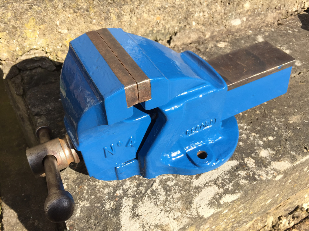

This is a Record I bought back in 2016, I had to drive down to Bridgwater to pick it up, which I was happy to do - the cost of the diesel to drive an hour each way was far less that what it would have cost via courier! It was in quite a state with many layers of crappy old paint, but after a going over with a wire whizz-wheel, and a coat of blue Hammerite, it turned out pretty well for the £50 it cost me. 😎

Record Roundel Blue paint here:
https://www.paragonpaints.co.uk/BS381C-110-Roundel-Blue-Record-Vice-Blue.html

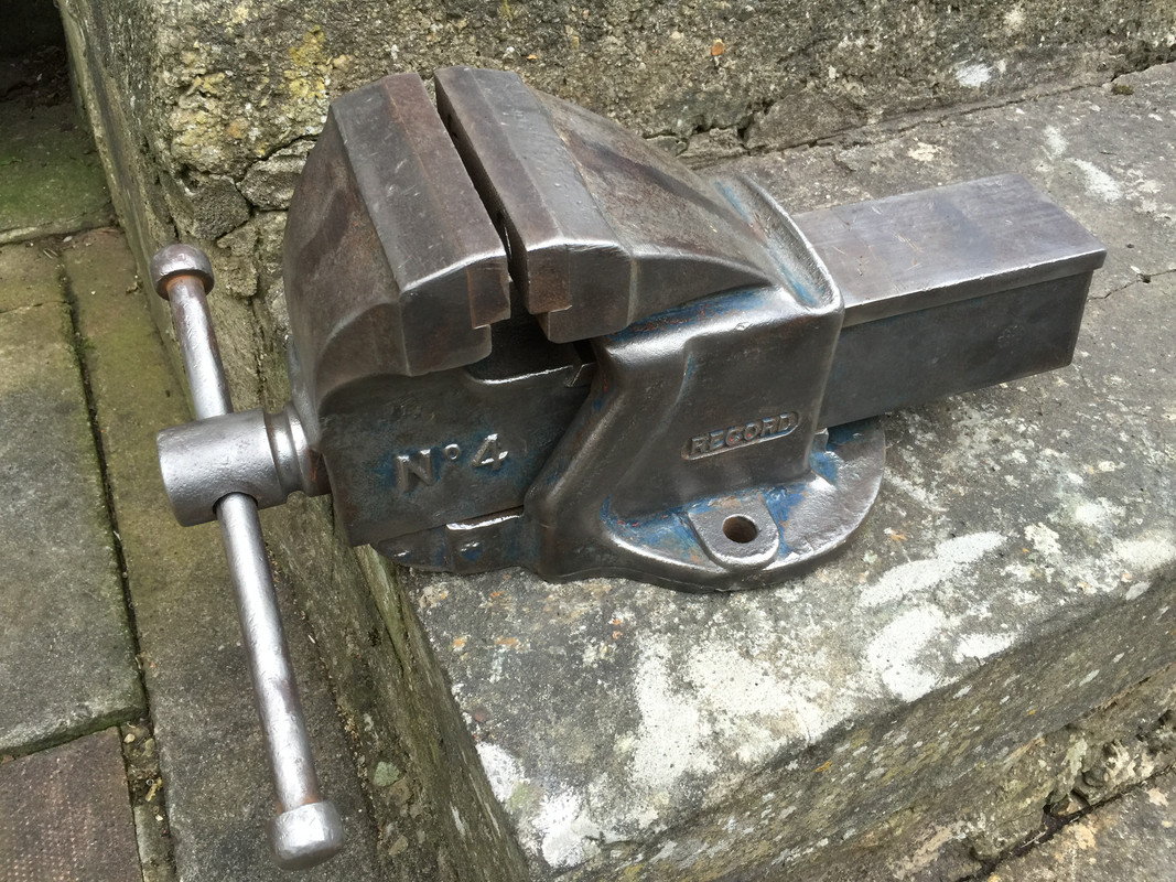

Posts: 5626
I’ve got a Record No6 sat waiting for a spruce up. I’ve already got the spring / pin service kit, just lacking some enthusiasm to get off my arse and do it.
If I can get it to look like CountZero’s before paint I’ll be happy.
