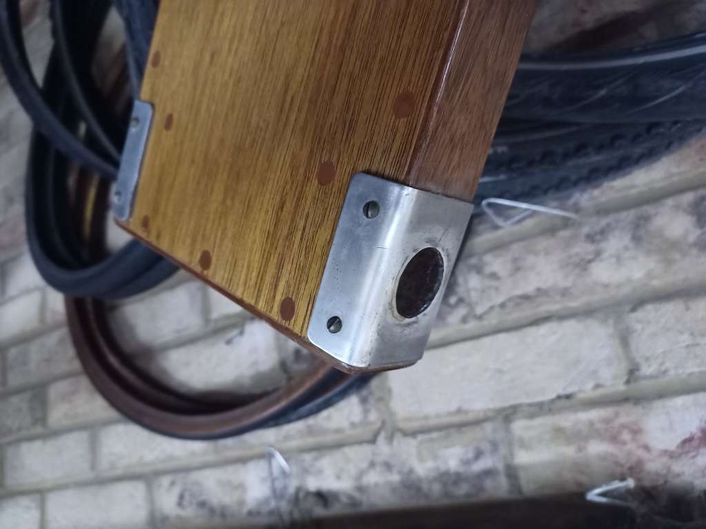

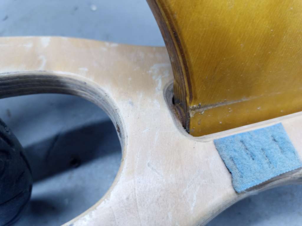

Posts: 3560
Bolts are stuck as last touched 18 years ago.... From memory I think it is a pair of short top hat bushes in the frame. Still steers fine and no play.
I have also once made a wooden frame but that would be overkill - bonded on stainless spreader brackets with 20mm stub tubes for a normal headset.
