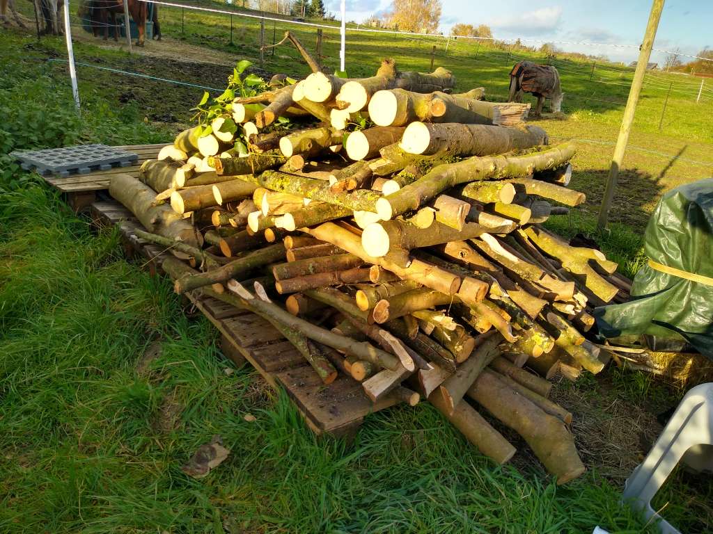

I've got the two battery version of that Makita that I borrow from a friend and it's incredibly efficient.  However it's also incredibly expensive and if there isn't a lot of stuff then I would have a Silky handsaw or a bowsaw.  Not as fast but not nearly as difficult as you imagine (if sharp) and a million times safer than the circular saw.  Most of this was with the Silky and it didn't take so long
IMG_20231115_153649719_HDR
