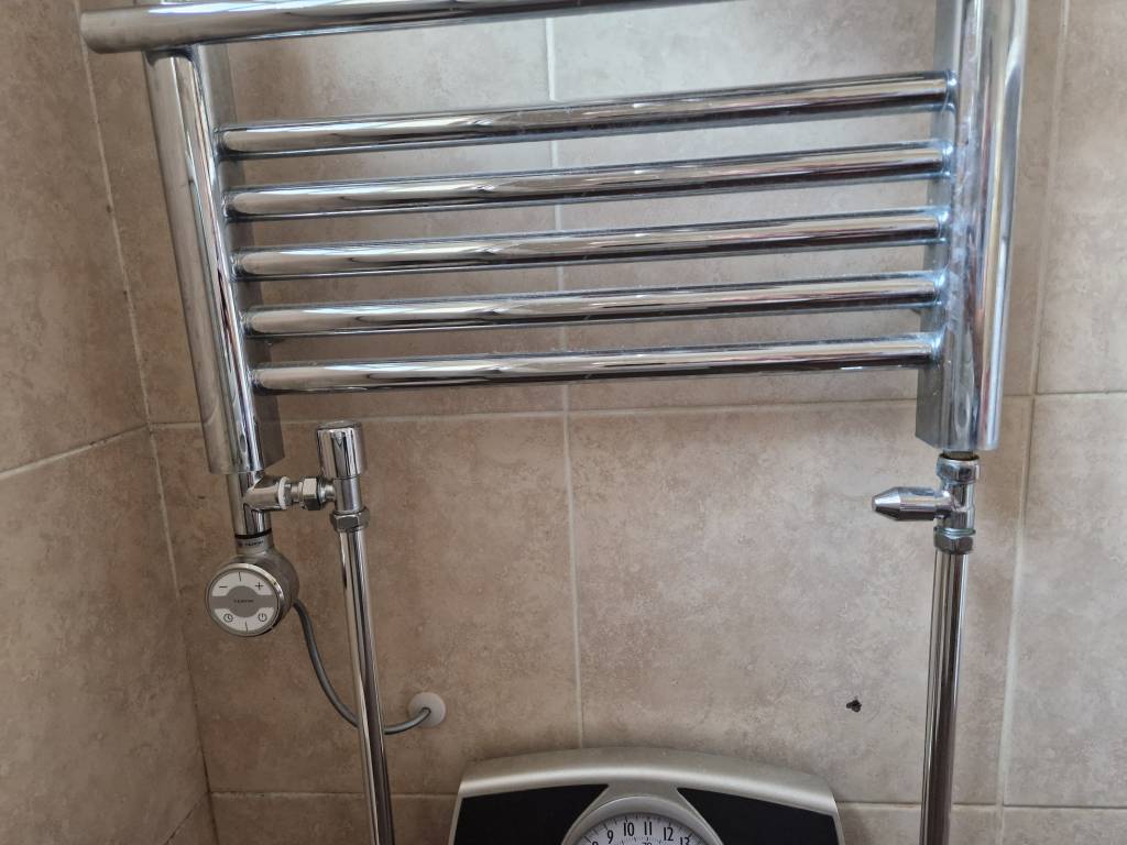

Time to try out this whizzy photo posting.  Yes, the heating element has an 'always on' button, and a timed button and a plus and minus to change the duration.  Bear in mind, when used with a plumbed in rail, you use a T piece to bring the hot water feed in from the side.  My old rail was leaking and I can't move the supply pipes as the floor is tiled so I got a wider rail, and you can get TRV extension pieces so you can get everything lined up easily.

Posted : 21/06/2023 6:31 pm
