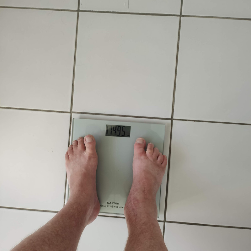

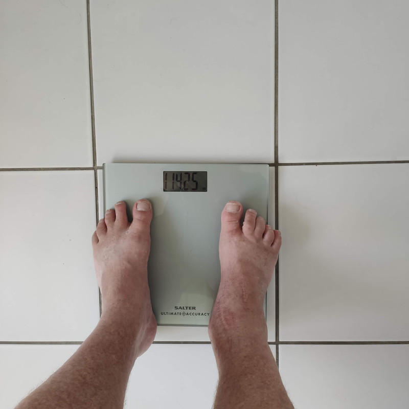

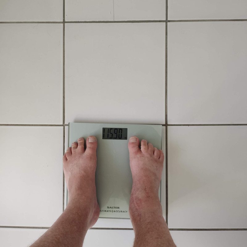

Posts: 13369
I have taken phots to prove the fault with the scale and its inability to correctly measure a static mass.
Look at the heel position compared to the logo at the back of the scale and see how little position change effects the weight. This was while attempting to actually get a consistent weight. I am sure I could have exaggerated the effect quite easily.
Ultimate Accuracy huh?
And obviously they are overweighing by about 10KG 🙂
Posted : 15/09/2021 4:23 pm

 poly
Posts: 8699
WCA - not sure if you've got massive feet or a particularly small set of scales, but in either case if you look at where your weight distribution is it is all at the back - when I use mine (I gave up - they keep telling me things I don't like) I try to have same gap from tow to front edge as heel to back edge. If MrPotatoHead is right and his are more consistent for wife and kids it may be they have smaller feet and are naturally more central.
Posted : 16/09/2021 2:06 pm
Also those scales aren't in the same place so that won't help
