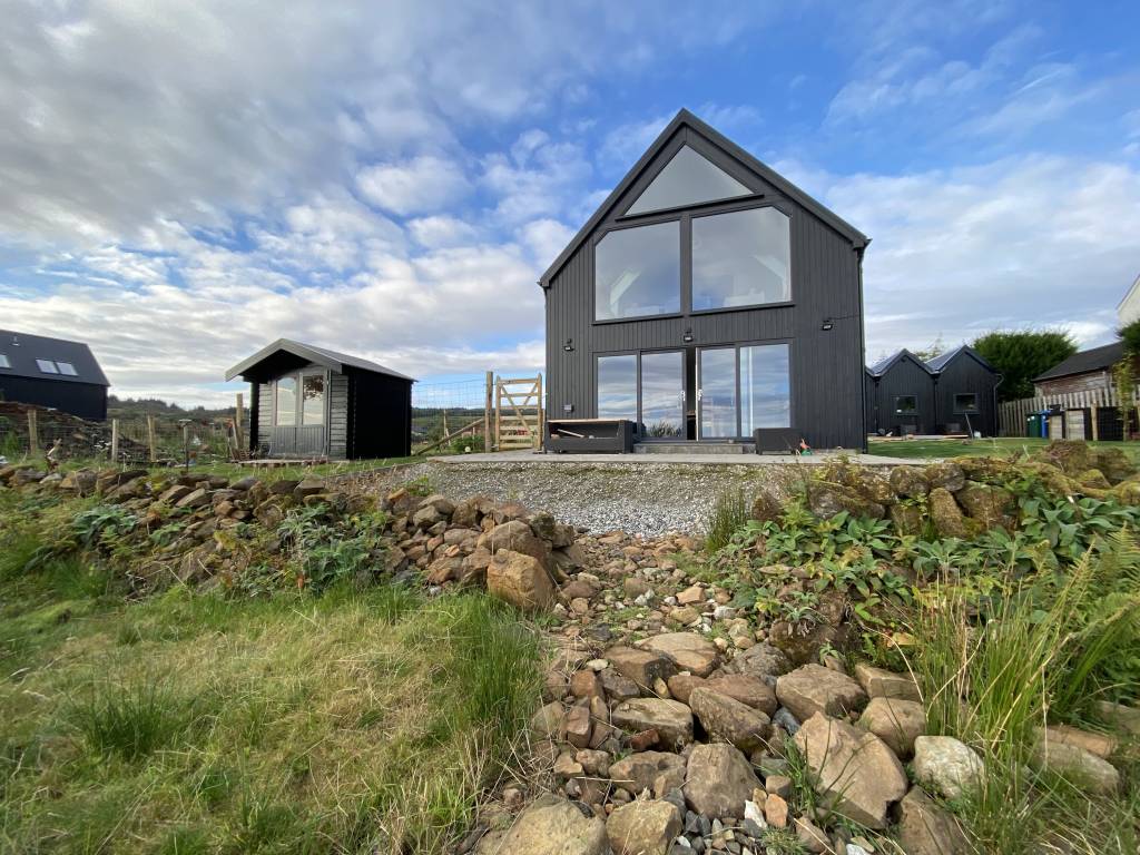

Shed
I made a 150mm wide and deep concrete ‘ring beam’ for mine, a 10ft wide Tuin log cabin.  It sits on a recycled plastic bearers. We’re pretty exposed and 60mph+ winds not unusual so it has some fairly hefty bolts into to concrete to stop it blowy away - you’re average B&Q shed would get trashed here.
